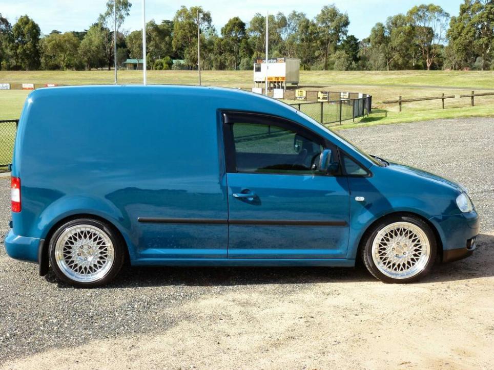

    three questions, i just got a new 2015 caddy swb looking to lower it and put some new rims on it,
    anyone know if the darkside kits work on this model and if it would void the warrenty if installed, two anyone know what the size rims i could put onto this model?
    thanks
    Darkside kit should be fine. Shipping is not cheap from the UK though.
    Warrenty - I couldn't say. Even if your warrenty isn't void your local dealer may not be prepared to help you.
    Up to 20" rims will fit but you will need to watch the width and et measurements or else they will rub. IMO 19" x 8.5 et42-45 shouldn't cause issues with the side door catching on them.
    I run 18" mainly for the comfort and tyre price considerations.

      I'm running H&R springs and rear shackle kit from darkside along with 19 x 8 et45's and haven't got any issues with the side door and IMO the ride quality is way better than standard suspension set up.
