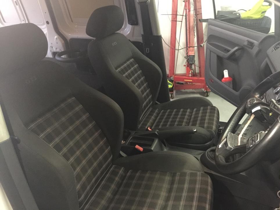

    Recently fitted GTI front seats to the caddy out of a polo
    Choose the polo as the seats have the side handle to allow fold back it allows easier access to back of seats

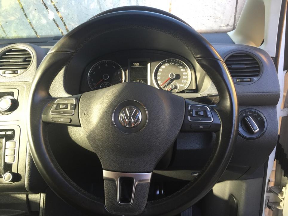

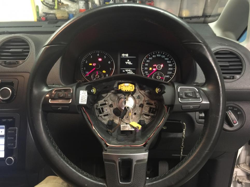

    Also fitted MFS and cruise control

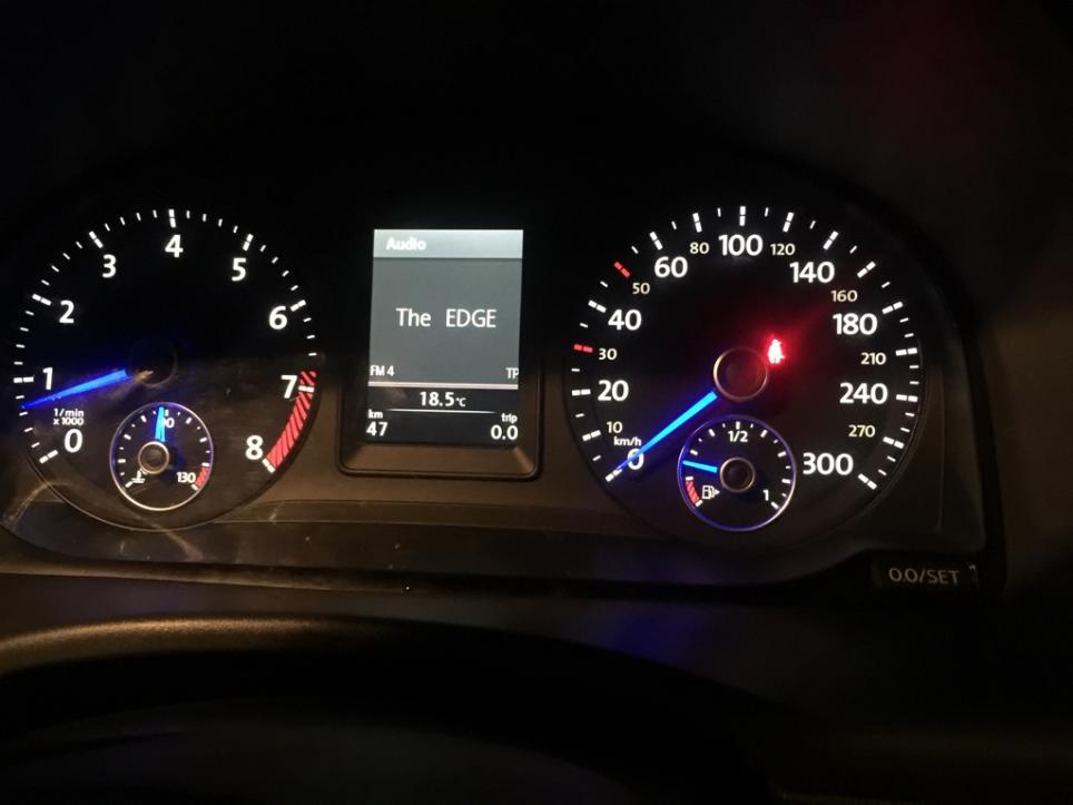

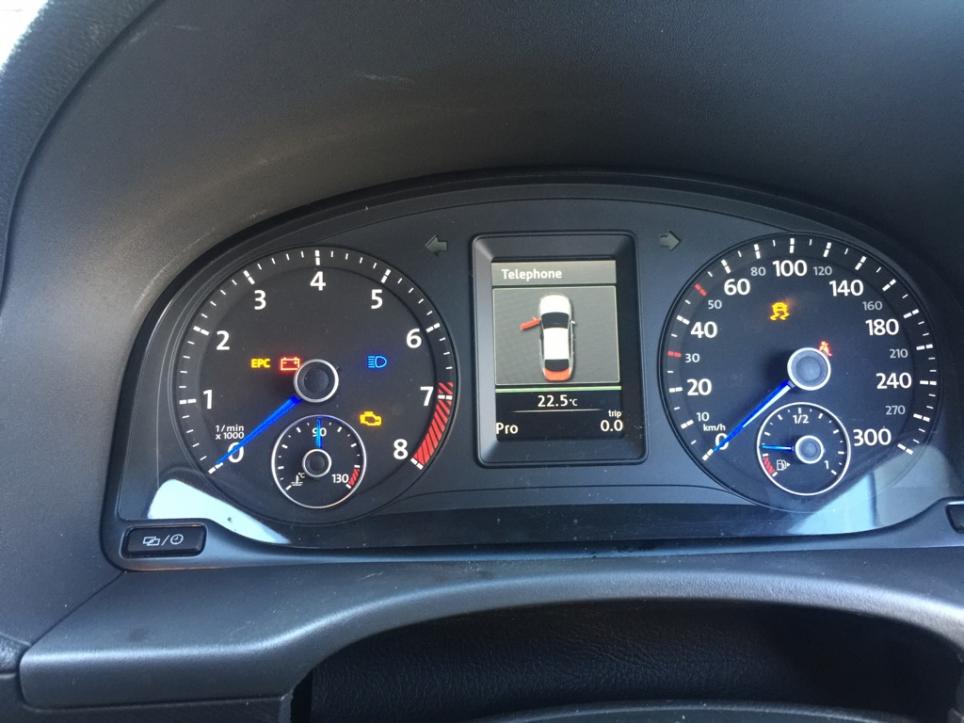

    Next is high line dash unit doing some home work first for options
    Good luck with fitting the highline dash. I was under the impression there was no one on Australia that can code the new cluster with the old clusters information.
    I've been wanting to up grade mine too had no luck so far.
    Using Tapatalk
      Ive come across a few people overseas that say they can do it if you send them the new dash and 1 key that is currently coded to your car. Anyone done this?
        i dont think doing facelift dash is that hard tbh. its the 2008+ pre face lift were the problem. Spacewalker from caddy2k offered to do that for me but i didnt feel comfortable sending my dash and a key to poland.
          Here it is
            Grtuned, where did you go to get the Mfa installed? Looks great!
              All done in house.

                  Have you coded it to display the sliding door?
                  Using Tapatalk
                    Grtuned, do you know if its possible to do this to a 2008 caddy? i have tried in the past to get a highline dash out of touran but no one in sydney could code it. one person gave it a go but his tools couldnt do the job.
                      Haven't had the time to actually go through all coding options
                      Just yet still need to play around some more. I'll keep you posted.
