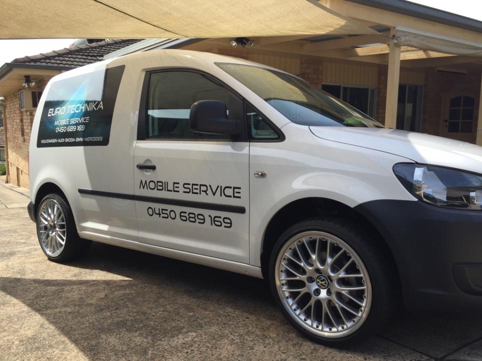

    New wheels for the Caddy!!!

    very nice. I hope theyre genuines
      Yep I thought they wouldn't fit being a 19x9 but all good so far good they came very close to the front shock but since driving no rubbing. So no spacers for the moment.
        What is the et of those wheels?

          Speed lines from Audi et 52
          Since driving over the weekend only noticed a slight rub on the front left strut under load while turning it just touched!!!
          These size rims come very close as I mentioned to front struts,the clearance when turning is good no wheel rubs on any wheel arch trim. The rear is perfect no clearance issues at all.
          I'm taking the wheels off the front and having them slightly shaved on the inner outer lip to give them clearance to the front shocks. Speaking to my wheel repairer to clean it up.
          But otherwise fit is great.
          Fitting a 19x8 or 19x8.5 would fit perfectly on a caddy.
