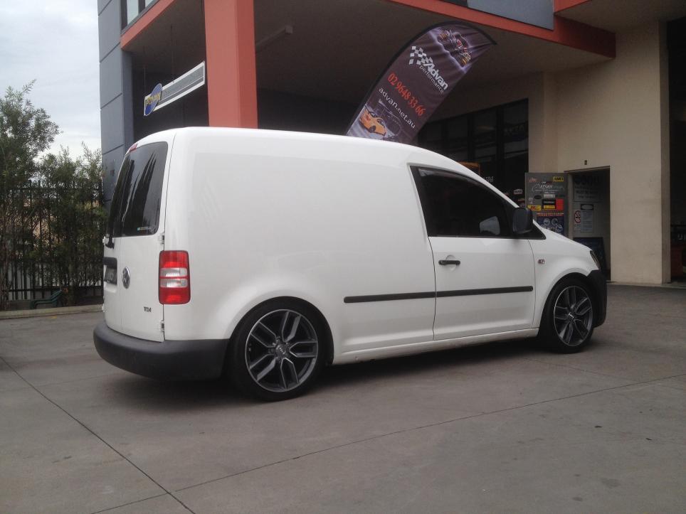

                  • #39
                    Hi all
                    I got the rear leaf spring flip kit from darkside developments in the UK. I got the 'super low' one so the rear wheel remains centred.
                    I got the bilstein B14 front coilovers + rear shocks from BMR Autowerkes in Sydney.
                    The front coilovers are on the lowest setting, the rear can go lower but am happy with it. Ride comfort is good, although the rear leaf springs will always ride like a b*tch unladened.
                    I am hoping to get some Golf R brakes soon. They will look much better behind the 19" wheels but also I find the stock brakes a bit spongy at times!
                    Here is a recent pic:
