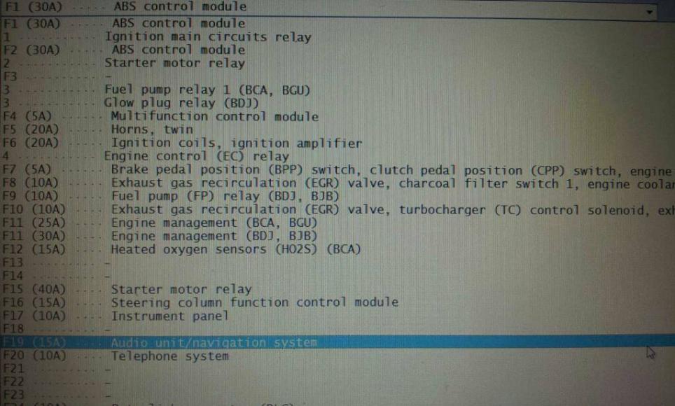

my radio stopped working, and having a look at the harness loom with a multimeter, there isn't any power going to the radio.
I'm suspecting it's a fuse, as I also realised my auto power windows don't work either... could be the same fuse.

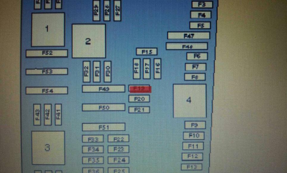

Does anyone have the fusebox diagram for this or can someone tell me what fuse is for the radio?
fuse 19 in the engine bay.
