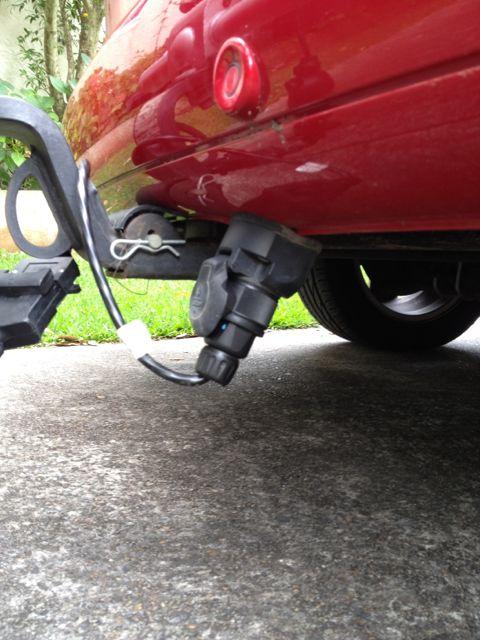

    The first is that the tow bar electrical socket has been installed on the underside of the rear bumper so that when you connected the VW supplied 13pin to 7 pin adapter cable there is only about 160mm ground clearance unloaded and when I have had the Caddy loaded with camping gear, surfboards, kids and a couple of bikes on a rack on the tow bar, the tip of the connector has hit the ground when I've gone up a driveway or over a dip in the road.
    VW say that the socket is installed correctly but "not installed appropriately for my particular use of the vehicle". The dealer (McGraths Sutherland) say they just install it the way VW tells them to. Neither will help in sorting it out even though I've pointed out to them that it probably violates the Australian Design Rules for vehicle ground clearance (Vehicle Standard (Australian Design Rule 43/04 - Vehicle Configuration and Dimensions) 2006 section 6.4).
    Here is a picture of it. Has anyone else got one installed like this?

      The first issue is not the way I've installed them.
      Due to the nature of the adaptor harness, etc, I'm more inclined to tie the whole lot up under the towbar out of sight and harm's way, with just the 7-pin flat plug attached to the bumper. No customer I've ever dealt with has ever complained about it being that way.

            That plug installation is bull****, any backyard mechanic would/should be embarrased.

              I had a very similar problem with my towbar installation on my maxi van. The towbar was installed extremely low and the plug was installed on a bracket off the towbar and located lower than the lowest part of the towbar. I loaded up my van with tools and then found I couldn't reverse into my driveway without bottoming out on the plug. After plenty of arguing and not really getting anywhere, I had a boilermaker cut and weld the hitch 65mm higher. This required a trim out of the bottom of the bumper. I also rewired the plug and fixed it on to the rear bumper next to where the towbar tongue is located. 2 1/2 years later not a problem.

                  That's a disgraceful fitment. I have only the simple flat socket screwed to the underside of the bumper, next to the towbar. If the dealer won't help you, go to VW Australia directly.
                    That install is BAD! Def would of tucked it up under the bumper or tapped it into the tow bar frame so it was out of sight.
