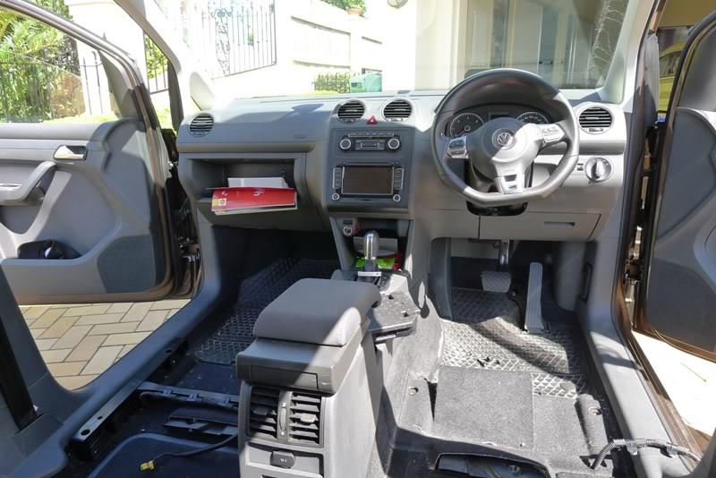

                        Did my seats over the weekend using Preeny's method

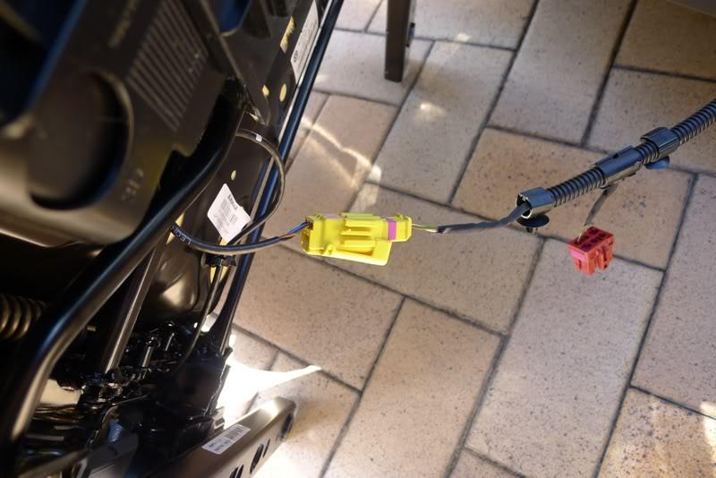

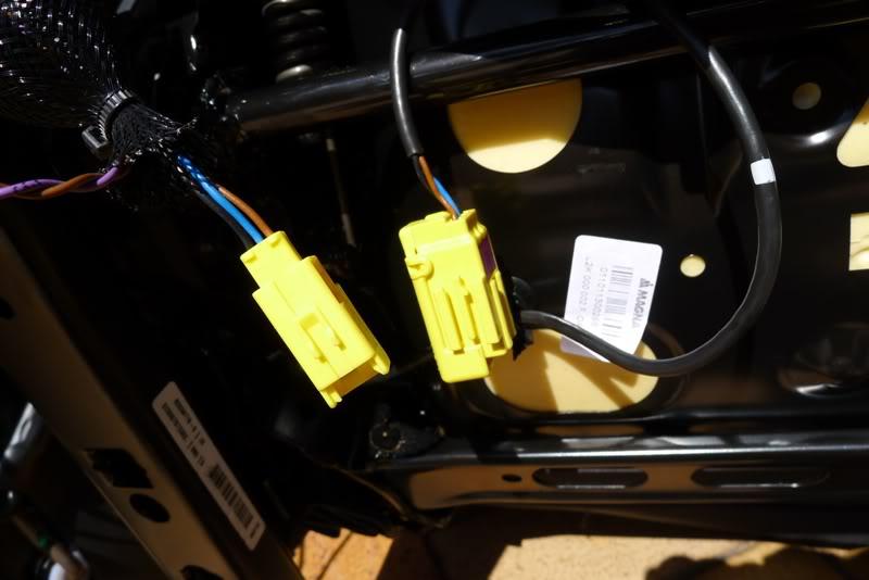

                        Here's the car's original wiring. From factory the plug was located at the seat (where other VWs had the plugs located in the floor). These plugs are generally found in VW / Audi starting 2002, where the plug is located under the seat. Unfortunately the mk6 has the plugs in the floor, so the plug type was different. The seat belt warning light plug was also different.

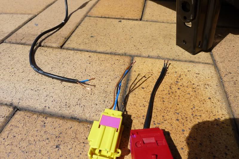

                        No worries, just cut and resolder them. Fortunately the colours match

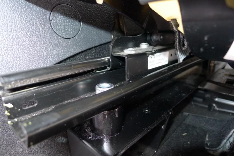

                        Following Preeny's advice, we turned some Ø30mm spacers 25mm tall with Ø11 hole drilled through - and made use of the 'tool access hole' in the Caddy seat bases which line up nicely with the GTI seats. Once I checked that the seat had ample adjustment with the shortest member of our family, we centered the seats and bolted them down with some M10 bolts and nyloc nuts.

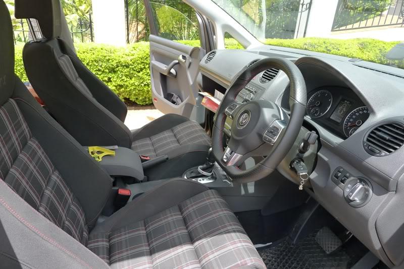

                        Plugged the airbags in, turn on the key, thankfully no fault codes
                        Very happy with the result!!
