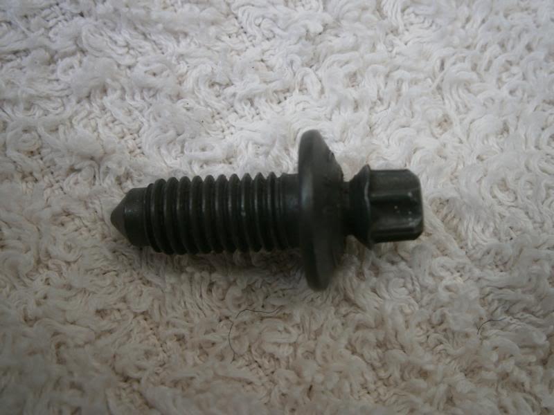

This is the replacement shear screw. An external torx E8 is needed to install. This design will be harder to remove once broken.
