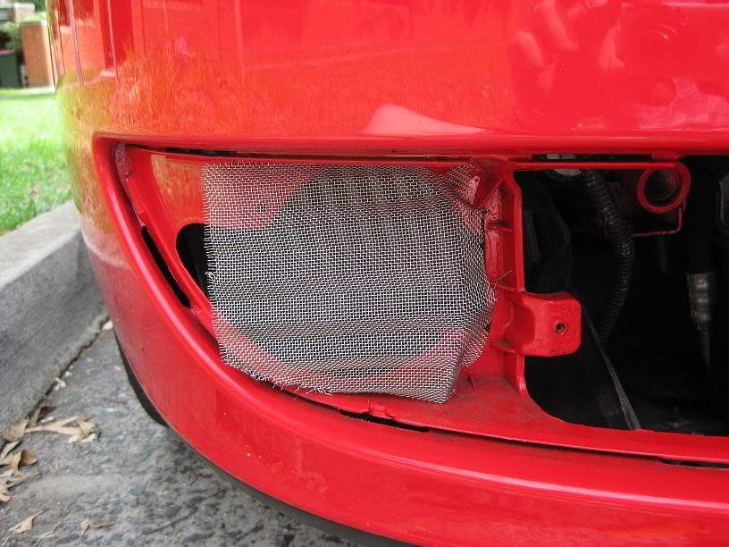

                        I'm going to have a stab at removing the fog lights and just replacing with some basic mesh to reduce the chance of stones damaging the SMIC.
                        Hoping to get a bit more airflow.
                        Will post some Pics

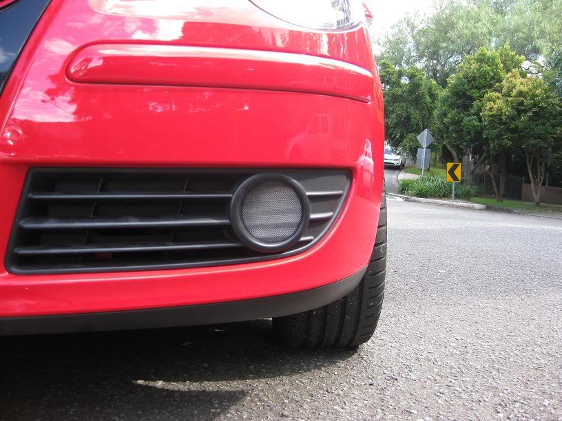

                          Had a crack at replacing the fog lights with some mesh.
                          Not bad for my first attempt, but could do better next time (and with some wire/tin snips)
                          If anyone is interested i've got more pics.
                          As the car does not get driven hard enough to get heatsoak issues often, I don't know if I'll ever be able to recomend this or not... Guess I'll have to accept if I do notice anything could be placebo effect.
                          Don't think it would ever compare to a FMIC, but for the few dollars of hardware, worth a try.
