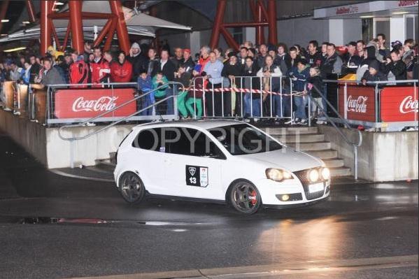

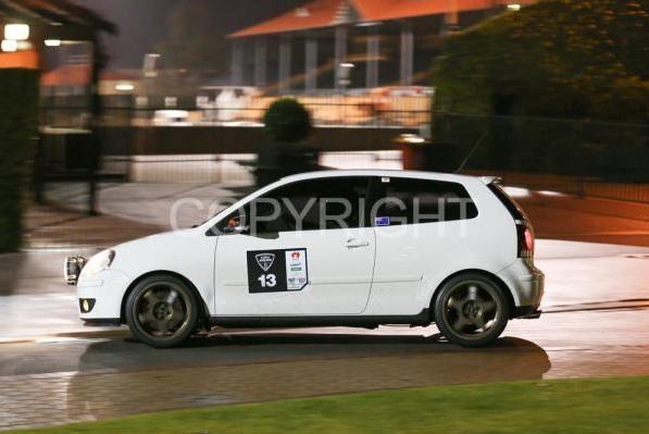

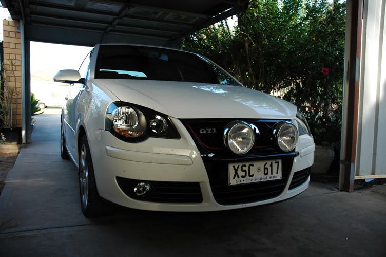

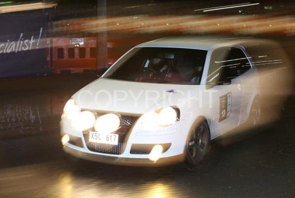

    Cibie Oscars, then later went to IPF in the photos below, these had a much greater spread. I always wanted to put two pairs on - two up, two down like an RS2000 but never got around to it.
    These were from Targa Adelaide. Top 5 finish!

        Normal OEM headlights, adding Cibie globes helped but not by much. The problem is the spread of light, not how bright they are.
        I used the normal alloy light-bar-mount thing that you see all the time. Repco or Autobarn stuff. I powdercoated it black to make it go away a bit.
        I cut a big hole in the bumper behind the numberplate, and then super glued in some threaded backing plates in place. They hold long enough to get the bolts done up from the front.
        The lights still wobble up and down, so i made some top tethers for them that went back to the screws at the top of grille.
        Worked a treat.
