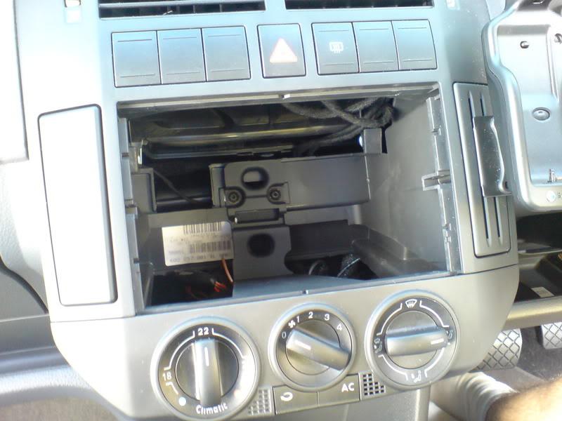

    Before I get to take the RCD200 out and have a peek inside, I'm just wondering if any of you guys who've cahnged the head unit could tell me whether a "cage" from a Pioneer unit (or any other Jap brand for that matter) would be a straight fit ie just a matter of bending out the tabs and sticking it in - from the photos you've posted before it just looks like there's just empty space inside with no "wall" the tabs can grab on to. Do you need additional brackets?
    Also I intend to mount the unit in the bottom half of the hole so as to leave space for a boost/oil pressure gauges in the top half in the future (to be filled by a cheap cubby hole in the mean time), but it looks like the hole for the radio mount at the back of the unit (bolt with a rubber plug) is actually at the top half of the 2DIN hole?

    There is a support for the headunit which I strongly recommend you purchase as the weight of the headunit may not be sufficiently held in by the cage. The headunit support can be sourced from the previous two 9N series models. To make your life easier as you have decided to put gauges in, you can also purchase a din blank (once again a geniune factory part). You can drill your 52mm hole's into them at where you find appropriate, and at least you wont have fitting issues with the Japanese din being smaller than the Euro din (Japanese din is about 2~3mm's smaller each side); not to mention you'll also have to custom retrofit a mount.

                  Roodosutaa - here is a photo of the RCD200 removed (taken when I was fitting my JVC AVX2 in). Hope that gives you an idea of what you're dealing with. Basically, it's just two long slats that act as the support - thus I say the requirement for the headunit support as it'll sit in between the cut-out groove (that divides the two din's).
