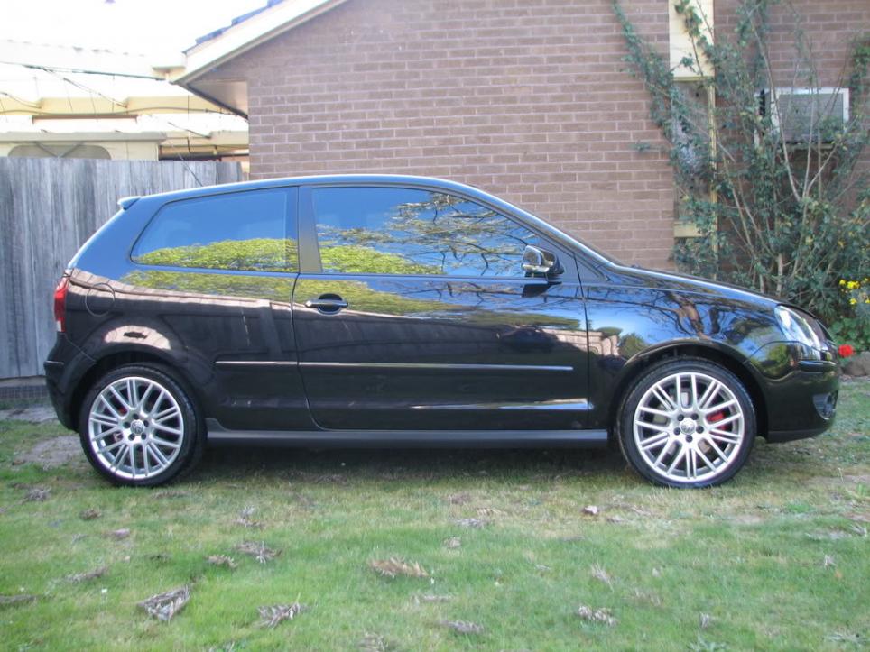

    I have just bought myself a second hand but absolutely immaculate Polo GTi and so far I am loving it. I decided to buy used because I have plans to modify the car a lot and didn't think it was necessary to buy new if I was just gong to void the warranty. Anyway, I am planning on an APR Stage 1 Brembo brake kit and i'm not sure if my current wheels will fit with it. I have the Exor STP wheels and I love these wheels so much and really don't want to change them. Does anyone know if the Brembo kit will fit with these wheels?
    Wheel pic (this is not my car, props to the owner for this one)

                He had the horrible looking 17s from VW. The Exor's look good. (unbiased opinion)

                Also, that's vkswgn's car.

                            love your wheels <3
