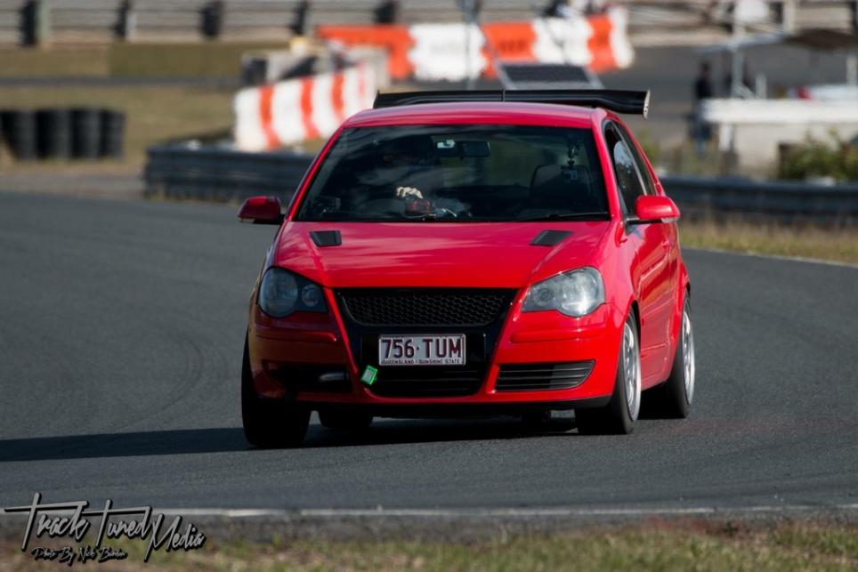

        I think the chalk should be adequate - they do it in timeattack and we're doing 7 laps (5x hot laps) and much higher speeds and temps than a hillclimb. Run it from side wall to sidewall across the face of the tyre. Use the thick chalk or make it thick. Should be adequate to see if you're using too much sidewall due to low tyre pressures. For this test, I'd start at say 30psi and adjust from there. I'd be cautious going particularly low on pressure for risk of the tyre coming off the rim or making the car snappy when it does run out of grip.
        Not sure if the pic will show well, but notice tyre deflection at the bottom of the front. That's turning in at a bit over 100kph, 30psi hot. I start at 24psi but have to bleed between sessions to maintain hot 30psi.

              BTW if you cut an A050 in half (section it) you will see that the belts on the sidewall and the tread face are not contiguous, this is what generates the grip and the heat (and the A050 is not unique, a mate runs a Proddie on Hankook control tyres and they are the same and I am sure there are others, but A048R are not, they have a belt that joins both "halves")
              But this same thing is also what see's the tread move around and look like it is trying to pull off the rim in seangti's pic.
              But this is not bad!!! Unless you hit something or run something like 12 psi the tyre will not fall off. But it also doesn't mean you are getting the most grip, which is why you need to try it out and find out what it feels like for you and your set up.
