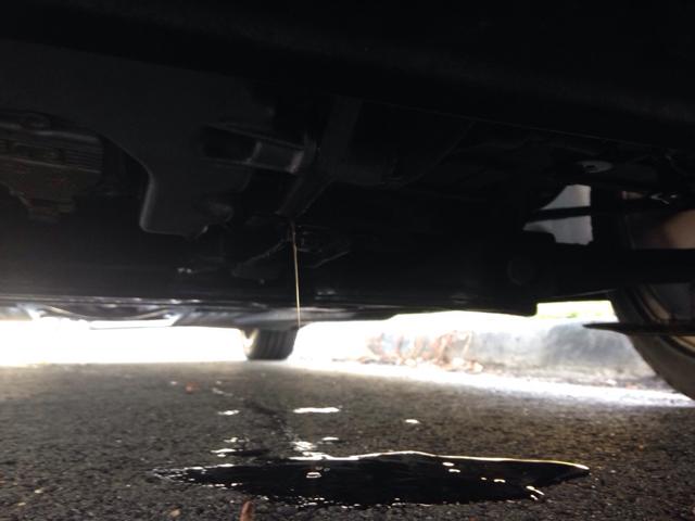

Was on my way to work today and heard a crunch from what sounded like the front left suspension. Initially I thought it might be something to do with the coilover, etc. When I got out to take a look there was transmission oil leaking out from where the engine meets the gearbox. [emoji27]
So had to coast it to the nearest mechanic which thankfully was only a few k away. Didn't have any issues with gear selection or grinding as there must have still been enough oil in there.
Long story short, the top of the gearbox is cracked and the oil has metallic flecks in it so it's toast. Labour is about 1000 to get it out (take out subframe, etc.). I've contacted ssman to see if he still has one available but happy to hear from anyone else who knows of an 02R gearbox anywhere in the country.
