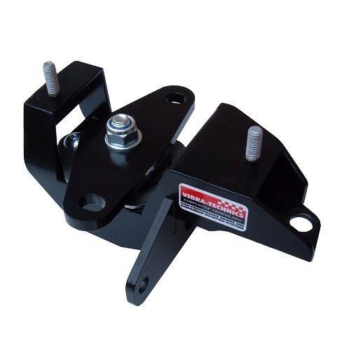

    This is the mount I was referring to.
    Left Hand Side Gearbox Mount Including Dsg - Vibra-Technics Compliance Technology
    Worked a treat. If you want to check it first I'd take the air box out and see how much you can jiggle the engine.
    I changed the insert in my dog bone/lower engine mount first- as you've mentioned. I've tried a couple and settled on the softest Powerflex poly one. I've got the next level up one siting on my desk that you can have for a six-pack + postage. It does have a noticeable increase in in-cabin vibration.

      thanks for your advice, will look into it and change it for good measure, the poly insert would be a great addition but the vibration would just drive me mad. Today car was running great no errors or wrx exhaust noise in the 40c heat. I can see why turbos hate the heat.

                btw your sig shows you have vibra technics engine mounts, how are they! vibration wise.
                • #38
                  Originally posted by barcode View Post
                  I hear you! 3rd gear is sick pulling, 1100kg
                  there perfect close to stock i would get them i only got the 2 mounts and have the superpro dogbone mount blew the first one and the 2nd is abit crappy kinda wish i got the vibra technics dog bone mount
