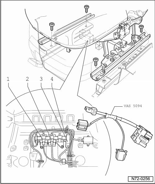

    I'm wondering if anyone has any idea on how to remove the seats from a Polo that have a seat height adjustment and storage tray? Has anyone out there done a seat transplant to a bucket seat or something similar? Any photos or any workshop manual removal diagrams would be greatly appreciated.
    GTI|BBS|Forge|Whiteline|Custom CAI+K&N|Sparco|Toyo|Martini|JVC|Focal|ScanGaugeII
    Really easy mate 4 bolts and air bag wiring connector. FIrst slide the seat all the way fwd , remove 2 bolts at the rear of the seat runners and then slide all the way back, remove 2 front bolts on the seat runners,

      Any idea what size the bolt heads are Jimmy? My set only goes up to a T50 in the tamperproof stuff.
        From memory mate M8 or M10 one of the 2.

          Ah, so it's a hex head not the tamperproof head? Can't say I've noticed, probably help if I actually look lol.
            Multi hex Bud

              Thanks Jimmy! I'm thinking of picking up a Sparco Sprint bucket. Might have to do some retro-fitting, but we'll see how we go. Thanks for the piccies again!
