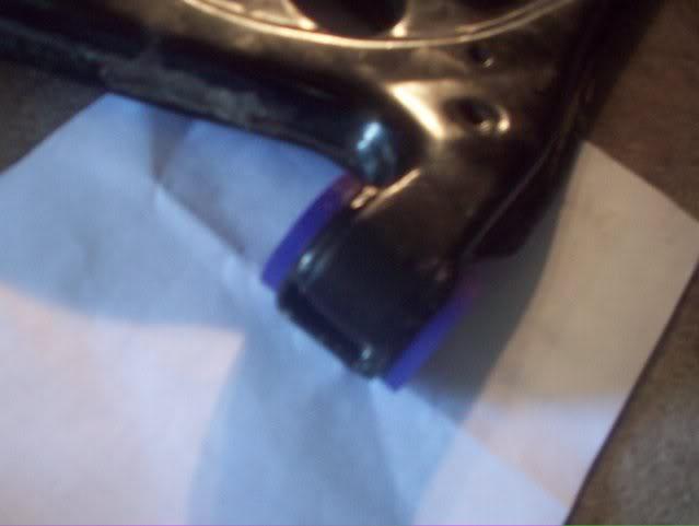

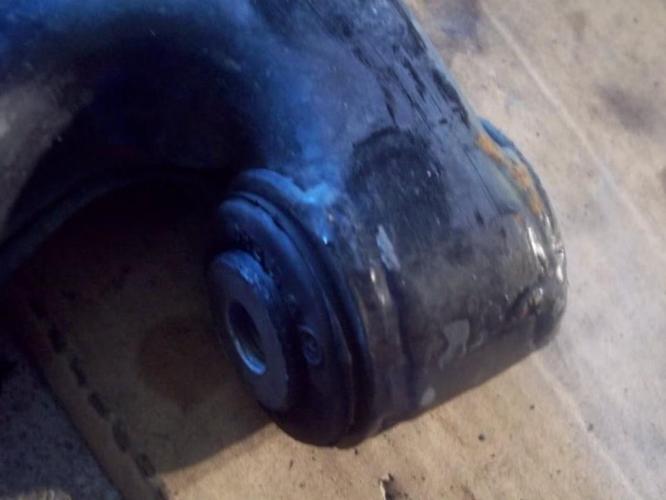

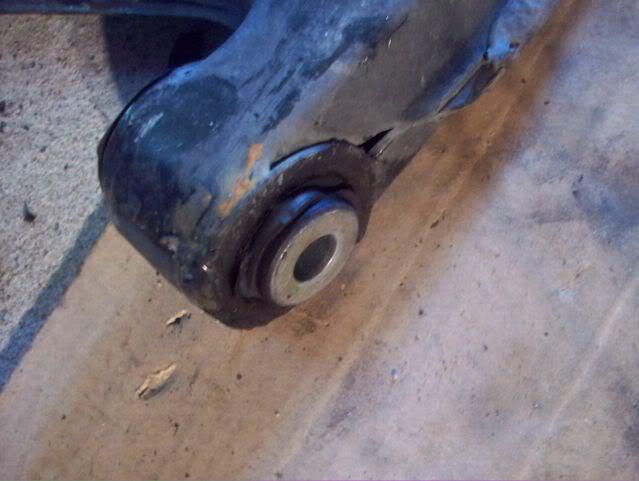

                  Well yesterday i finally got around to getting Jimmy Mac to put the wishbone bushes put in my car. Big thanks goes to Jimmy for his fantastic services as usual. My very first impression was the steering felt more direct. Then today i went for a run up some mountains and when i wasnt stuck behind motorcycles i must say its more confidence inspiring through the twisty stuff. I also havent noticed any axle tramp when taking off from a standing start. But on that ill tell more once ive gone out for a real drive esp at the drags.
                  As you can see by the below pics the standard rear wishbone bush is voided, where the one i replaced it with is solid. And the front wishbone bush has been replaced by a polyurethane one.
                  Now i know alot will say these could be placebo affect because of putting them in and hoping they would do something. But i have let JASN78 take the car for a mountain run last week and again this week. So he can give a unbiased opinion. And anyone that wants to come and have a drive of it feel free to pm or call me and organise a time.
                  Ill take some picks and show you what the standard bushes are like and what the ones i put in are like. With some info about them.
                  Ok it went from this. Rear wishbone bush
                  to this rear wishbone bush
                  and from this front wishbone bush
                  to this front wishbone bush
                  the other option for the rear wishbone bush
                  is to use this
                  which looks like this
                  Now i will wait for Jimmy to chime in on this but the later option is much quicker. I went for the first option so i could be 100% sure they fit. Which they did. And also to work out how the second option works.

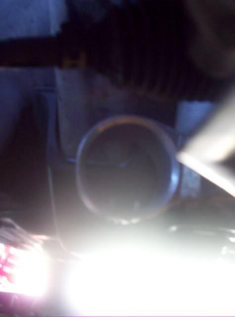

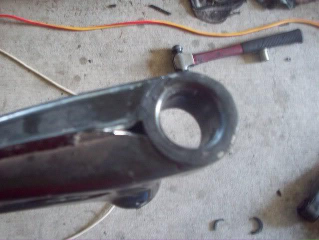

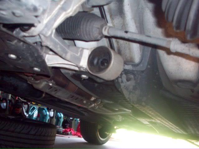

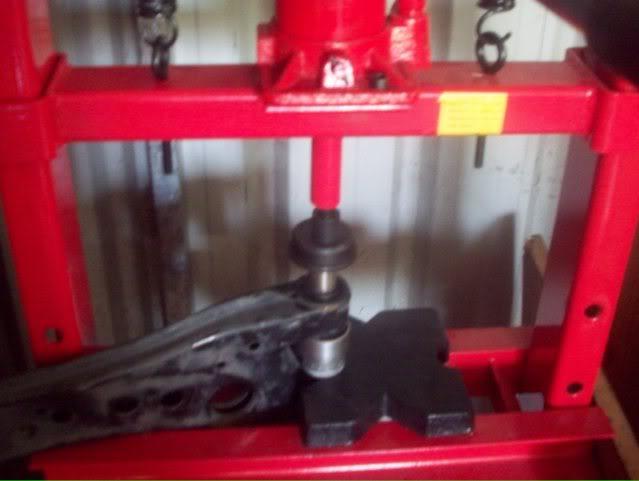

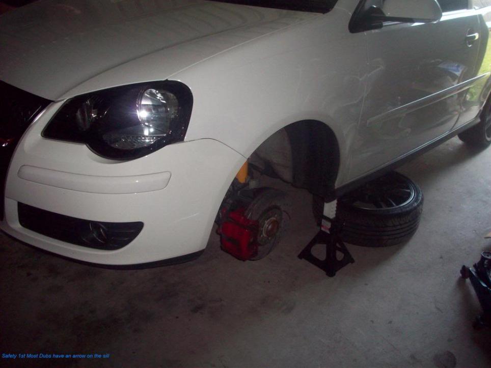

                        Safely place the car on stands

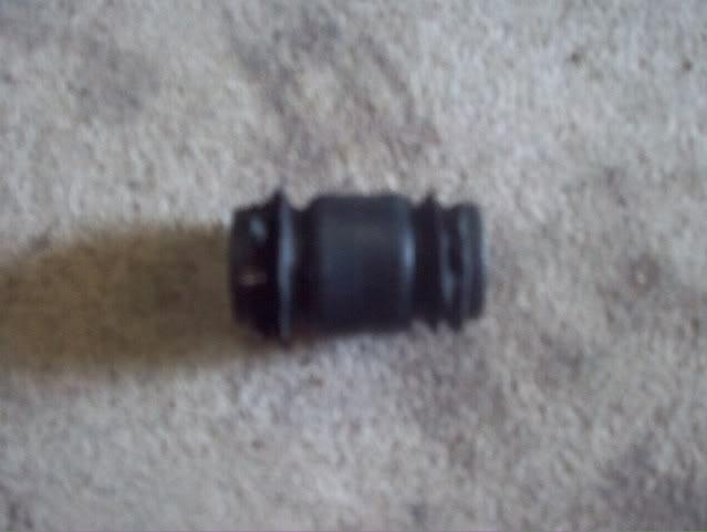

                        This is the bush pre press - cut the lip of the bush to make the press out easier
                        Lip cut off bush
                        Press out bush
                        This is how it looks pressed out
                        Clean out the orifice with emery then you rubber grease the new bushes
                        New bushes installed

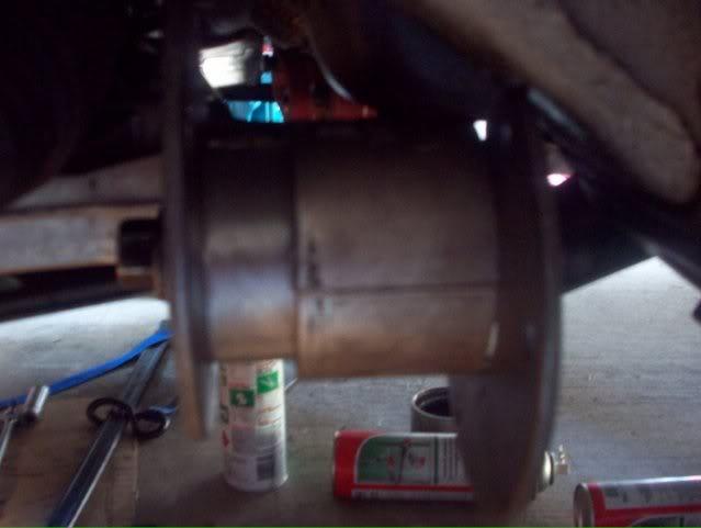

                        View of old void bush in the alloy console
                        View of the bush removed. You remove the original (Nylon) by cutting and splitting
                        Installing new bushes ( clean/dress the console oriface and clean the new bush) press in bush with void bush tool. Very tight alloy to alloy, just make sure and SOAK the bush and console with lubricant. Flats of the hex in the bush must sit top and bottom as the wishbone is keyed this way. If you leave the console on the vehicle you will need a good ratchet strap to pull the arm back into the console bush, also soak this in lubricant
                        Next step - Torque all bolts and have fun
