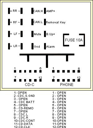

Ok, so I've been researching to get AUX working in my car which seems to involve expensive equipment but I am thinking there is a work around to it, see a pin out below;
And the back of the RCD200 shows;
This area of the headunit seems to be used for a cd changer but can also be used for aux input.
I have highlighted the pins in red, the pins required seem to be pin 2, for ground, and pin 8 (L) and 9 (R) for aux, connecting these and providing an aux signal will should get it working.
Has anyone else had more experience with this?
