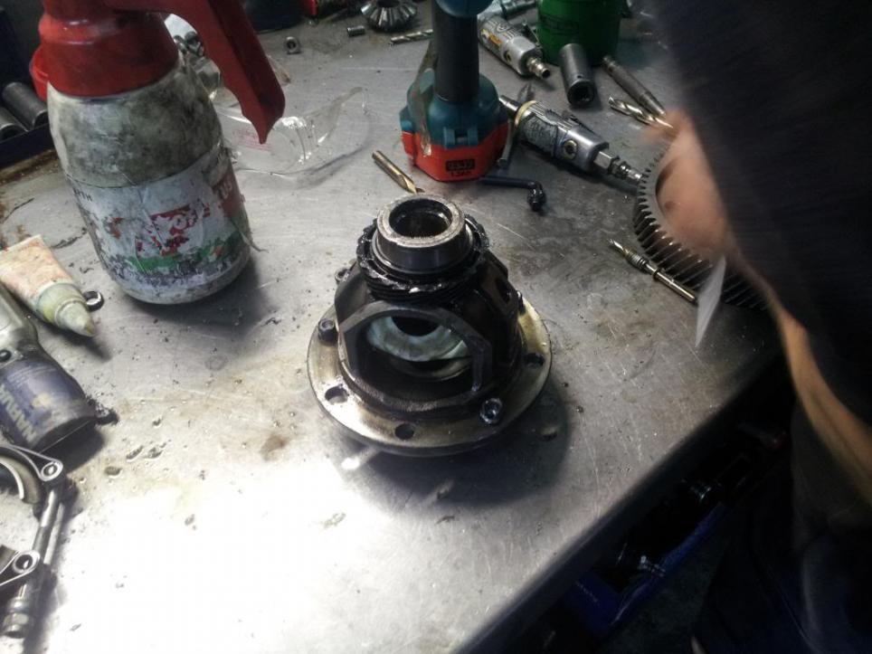

                  Backlash will be a new experience but I'm not hesitating, yet. Care to elaborate?
                  As for getting the rivet heads off, I was going to do this at work. I have enough gear there to do the job effectively.

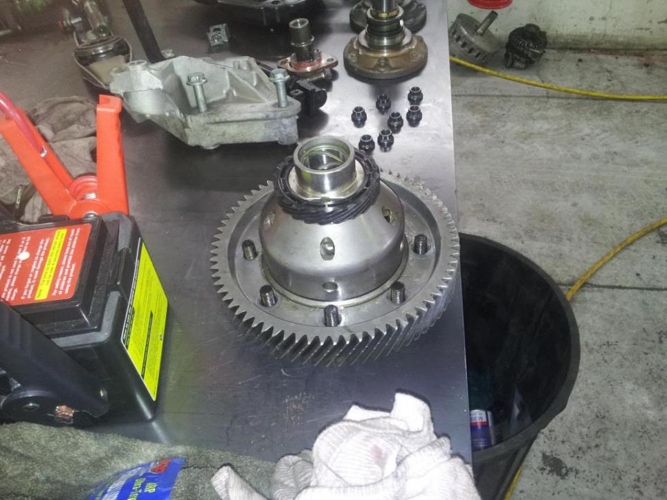

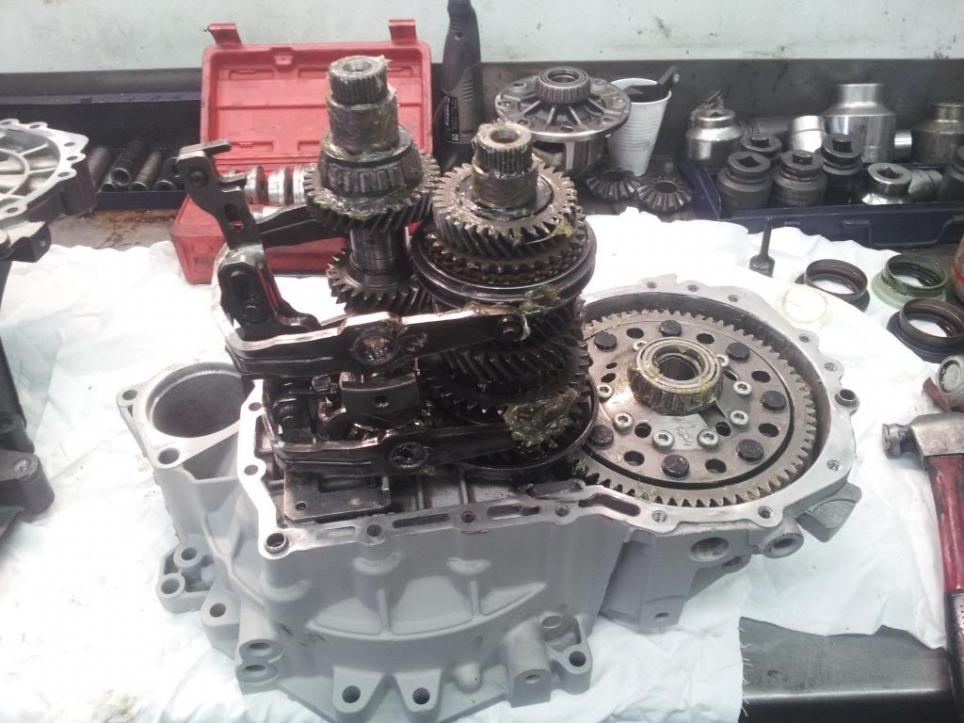

                    from when i did mine
