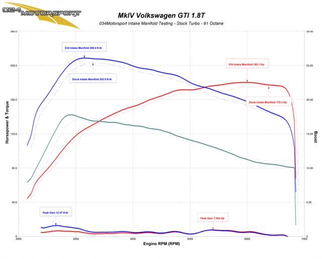

                X2 would be keen to get one of these. +20hp on a gt2860 is pretty impressive for just an intake manifold
                  That's low boost too mate!

                      The power gains are not great for a small turbo, maybe if you had 400hp. I am still more interested on the SEM or the Intergrated Engineering ones
                      Oh and i was looking at the first post where it made less than 5hp on a stock turbo car

                        That's peak power mate, look at the increase under the curve and it's right across the rev range in both power and torque. For a stock K03s on crap fuel I think this is substantially better as it's not robbing power or torque from any other part of the rev range. Not to mention the peak torque increase of 16.9nm.
                        And unfortunately you won't physically fit the IE manifold in the Polo. It's massive even with it's short runners.
