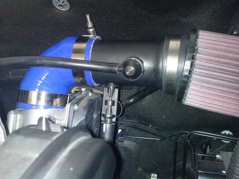

    The intake pipe is relatively straight forwards. A 2.5" straight mild steel tube with the ends stretched to 2.75" (to suit the K & N). Once this was achieved, 2 holes were drilled out to accommodate the 2 rubber grommets which were removed from the airbox along with the sensor. You will note that the original vac tubing for one of the sensors is not long enough, so thus 8mm vac tubing is used to ensure the distance is achieved. Once completed, the silicon bend was attatched to the throttle body, and clamped. Then the 2.5" straight pipe was clamped along with the pod on the end.

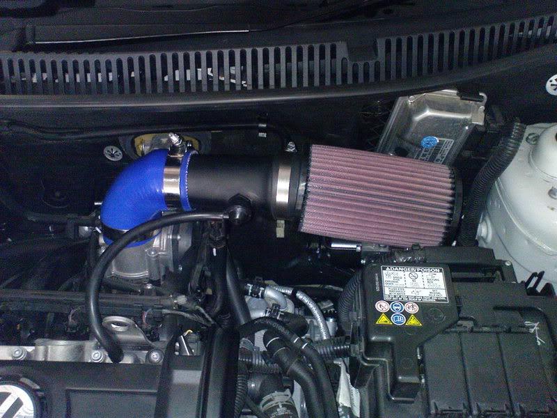

    Sneak peak...
      Hey dude - You'll want to atleast create a box around that pod.
      As it is right now it will just be sucking in very hot air from the engine bay into your engine. It might feel faster because its alot louder but I bet it'd make less power on a dyno on a hot day/after abit of a hit.
      Must say though, it does look well done for what it is

        I've thought of that before. There is a heatshield of some description and another air feed pipe to go where the one old previously was (in progress). Yes, quite frequently the noise factor often makes you feel faster, but rest assured, there is a slight increase in throttle response.
        I've reasoned that where the pod is, is probably the coolest place in the engine bay. How? Well, the ECU and the airbag unit are both located in the same area (hopefully meaning that it's possibly the coolest place in the entire engine bay). In actuality, the coolest place is probably on the far right hand side of the car just behind the lights, but after doing some more homework and trying to create a proper mount and taking the lower pressure feed into consideration kind of threw the idea of making a longer pipe to make use of the void space.

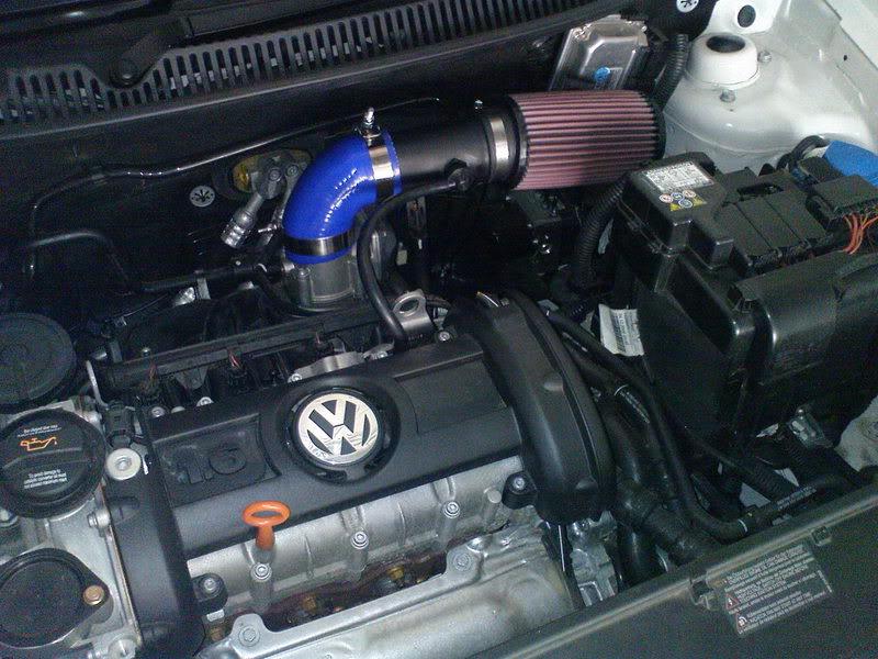

            Here are photo updates.

              You'll certainly get criticism here by the looks of it, but yea I think it's fantastic. Certainly feels like it's breathing more freely, as it would, and noise it make is just fantastic, which does make it more exciting to drive! It's hard to judge performance gain when I drive a turbo everyday, but if you're happy - I'm happy . I've found panel filters to be fairly inefficient when it comes to gains vs dollars, I had one on my SP23 (only because it was $60) then ditched it in favour of a full AEM CAI. I've thought about one for the GTI, but again talking to Harding Performance, it's just not worth the money.
              We've been mocking up plans this morning for a 'cool air feed' from the front, so we might tackle that stage tomorrow??
