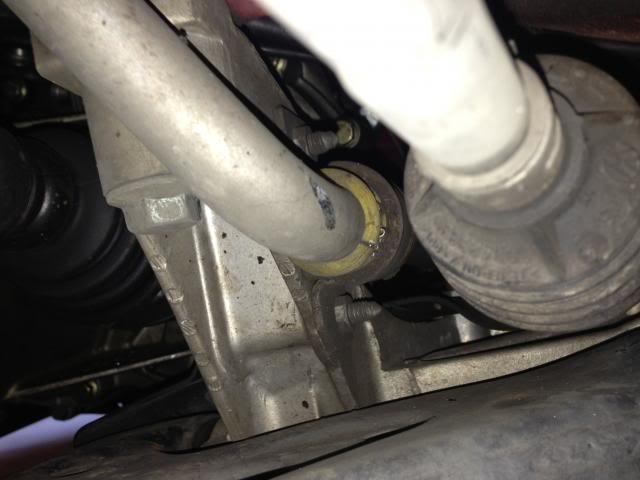

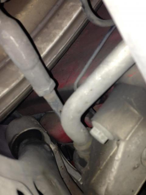

                              Guys found my culprit today
                              1.
                              2.
                              3.
                              Only ever heard it hitting bad at near on and full lock each side.
