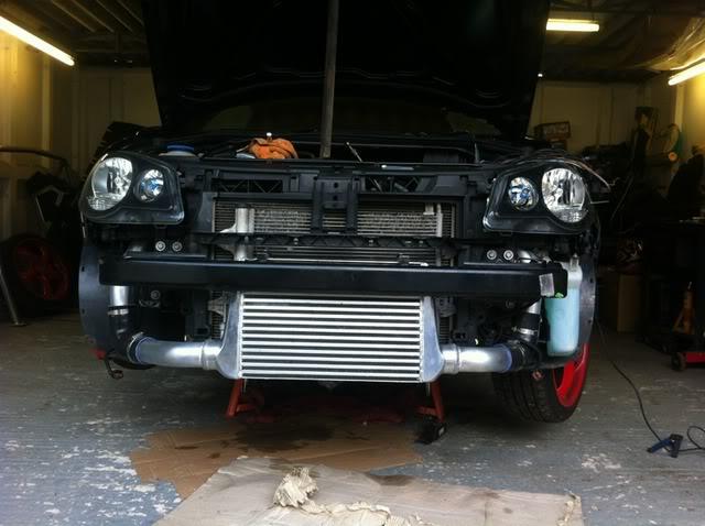

                I will go for a single pass intercooler. Leaning towards changing the end tanks on the THS as it has such a good core. Plus it fits well across the front of the Polo. Unless I can get a good single pass bar and plate intercooler at a good price. Any suggestions!
                  So many good off-the-shelf single pass coolers, seems a shame to hack the THS (then again, its got the bracketry all good to go).
                  Id be concerned about making it have eddies and weird airflow, but I might be overestimating the engineering that goes into a cooler.

                      I agree about the air flow.
                      Not sure if it was designed as a dual pass having larger gaps to improve airflow. Seem to recall that it was the same core that they use for their golf single pass ones, though not sure.
                      The fact that it fits already, albeit just is a major positive.

                        Is that 2.5in or 3in piping?
