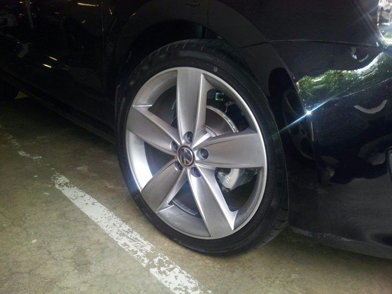

    A new polo TSI in the work carpark. Wears 17 inch wheels and 215 / 40 /17 tyres.
    I wonder if these would fit a 9n3?

    Well, they are 5x100, so it just depends on the offset, but I assume it should fit no dramas.
      The et on those is 46 vs 35 for post '06 9n3s so it might be close on the inside.
        Sorry, for 35 above read 38.
          46 on a 7.5" or 7" will probably clash, 45 on an 8" rim clashed with the KW struts in the front.
            ive thought of this too. the new polo GTI gets 17" snow flake alloys, over the 16" ones on the 9n, so was wondering for a more OEM look on mine to put on the new Polo GTI alloys, but maybe they wont fit?
