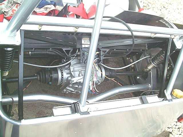

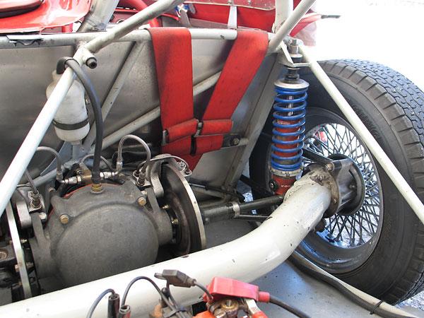

                    Mmm, what about scrapping the IRS rear altogether and sticking with the beam rear axle?
                    Two arms to hold the diff on.
                    Or a DeDion tube setup. It's a sort of hybrid IRS/beam. You can see the basic principle here --
                    The more I see it, the more I like it.
                    The rear diff fixes to the body and the 'beam' connects the two arms around the diff.

                            This is a bit more conventional, no inboard brakes, smaller tube --
                            Can't you just see it in there Jimmy
