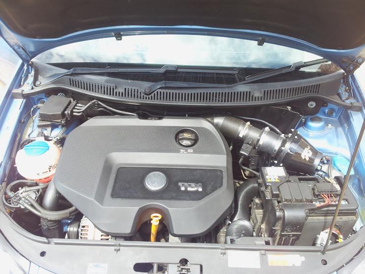

    any TDI guys here fitted this on?
    SEAT Ibiza SEAT Sport MOMO Strut Brace
    also found a actual fitment on tdi here
    VW GTI Club &bull; View topic - 06 Polo 1.9Tdi Sportline *SOLD* ****
    06 Polo TDi
    I understand the TDI and all other 9n / 9n3 Polos take the same suspension and should take the same strut brace.

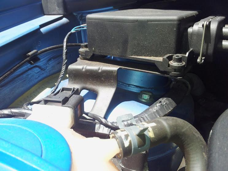

      The TDI has a vacuum pump thingy mounted on the driverside strut tower so GTi strut braces don't work without relocating the vacuum pump thingy.
      Evaded M/S went in to this when the Ultra Racing strut brace was discussed with the Malaysian guys a year back (he decided he was going to cage the car so he ditched the strut brace idea).
      Resident grumpy old fart
        I agree the suspension should be identical

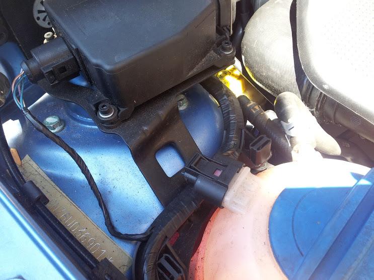

        but there is a vacuum distribution block on the driver side strut top of the TDI
        check this
        06 Polo TDi
          Oh...
          Are the connections all hard lines?
            connections are soft, but don't have a good place to relocate the block
            need to extend all the connections to relocate it as well, it's a lot of work

              If you look at the UltraRacing group buy thread, on page 15 there are some photos of the installed product. I think you could probably mount the Vac system to the brace, or move the bracket up an inch or so to find clearance. Solution probably depends on how willing you are to modify whats there or do a little fabricating (or for me, using zip-ties).
