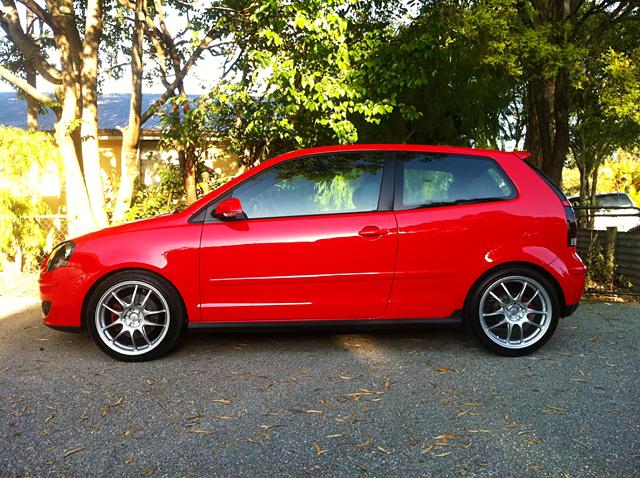

          Looks ace on the PF01's.

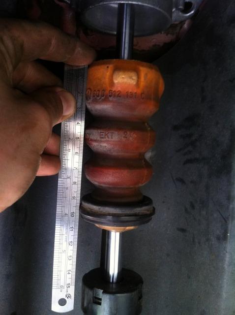

                        I checked out the rear suspension today and Eddy is right on the money. I took out the rear adjusters, put a wheel on and jacked it up to where it sits. At it's current height, there's only half an inch of shock travel before it hits the bump-stops! This is the current height of the rear bumpstops --

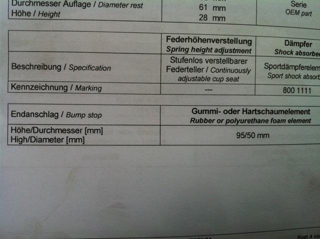

                        ...and this is a picture of the KW manual with the specified bumpstop dimensions --
                        Where do you measure the bumpstops from, the extremities? If so, then they're currently 110mm instead of the required 95mm

                          Watch where you cut if you want to keep the dust cover. And at the other end don't cut too much as the hole in the middle isnt the same diameter all the way through.
                          • #73
                            I just had a look under my car, from what I can see, seems the rears are close to riding on the bump stops.
                            Interested to know if cutting them down is a good idea and by how much. As the top and bottom section seem to be the most relevant in terms of fitting into the required areas, would it be better to try and cut out the middle section? Are they fairly solid?
                            As the perches are designed to be "in", I would expect the rubber should be cut down to 95mm then remove the thickness of the perch as well (so maybe 70-80 total)

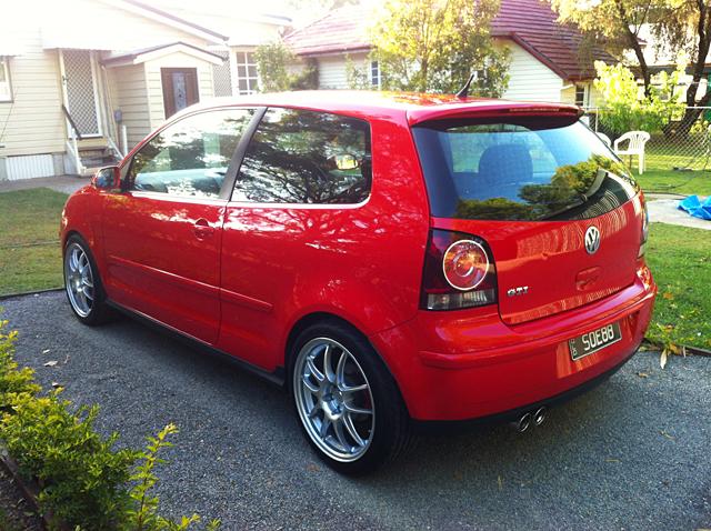

                              Also had Kevin from Precision Guard Rolling come up and sort the guards out. I can't recommend his service highly enough. He rolled the lips on the front, macgyvered some tabs for the front plastic liners and rolled the rears. Theres plenty of room now. Obviously if you slam it over large bumps its going to scrub but for enthusiastic daily driving it's fine
