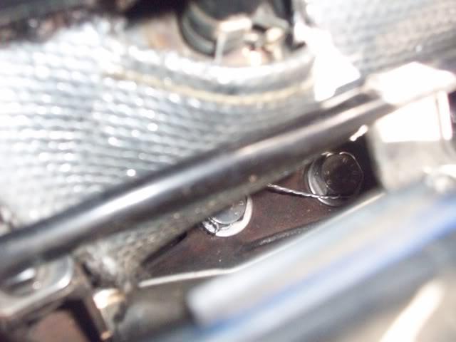

                        • #27
                          Ill be watching this thread.. See what some rotor geeks come up with.
                          • #28
                            After LOTs of pondering i am visisting an engineer tomorrow to confirm if my new idea is going to work, in my minds eye its a belter. i have successfully lockwired a K04 with 31thou lockwire and as ive already mentioned im having a longer set that with go onto a meaty manifold and K04 being drilled out to 42 thou for 35 thou lockwire, and ive also mentioned i spent some valueable time at an aircraft shop with the engineer testing the wire with heat. i figure this with my new fix if i pull it off will then become a 2 lock system thus making it hard for the bolts to loosen
                            By the new fix isnt studs or tabs, very different
                            Stay tuned
                            Here is sneak peek at the lockwire, but like i say there is an extra marvel going in there soon hopefully
                            Jmac
                            Alba European

                              • #30
                                Took my latest idea, and by the way i have thought this one up lying in bed so blame the subconscious mind for this one!!! I ran it past the engineer today and he actually smirked and said mate is going to work. I am pretty exited about it, stay tuned for this, i will test run it on K04 install that will be happening soon and then i will offer it to any casualties, otherwise let sleeping dogs lie, ive seen Pogs with 90k and the bolts are good, and seen them low kss loose. Ive seen locktabs mentioned, wirelocking which i still might do as a secondary anyway and studs and nuts, This one is close to locktabs but not quite this one is one more level over that.
                                Thats all for now
                                Jmac
                                Alba European
