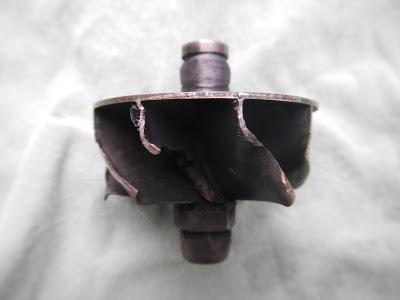

          At the moment I'm working on 2005 Golf 1.9TDI, I know it's not the same engine as in Polo GTI. The car had all scheduled services done on time and now at 92,000km the turbocharger failed. It will cost the owner around $3000 to get the engine running again. The engine didn't show any decrease in performance until the end, when it just stopped.
          So, I have to say that you should use only VW approved oil and perhaps if you drive under severe driving conditions change the oil at 7,500km or 6 months whichever comes first. It could save you +$3000 somewhere down the track.
            How are you so sure it was a lubrication-based failure?
            The PD TDI engine is very picky - it requires either 505.01 or 507.00, both of which were pretty rare back in 2005 (apart from the dealership - and even then, it wasn't guaranteed they'd use the correct oil). Has this car been using the correct oil?
              You've answered your own question.
              I'm sure there was no VW507.00 back in 2005 anywhere in AU.
                  To the OP, you can always get Shell Helix Ultra Extra or Penrite Enviro + 5W30 from SuperCheap Auto.
                  That's a pretty standard stunt for those early TDI Golf 5s, Miro.
                  Coinciding with what you've established, the ones I've fixed had a pretty blase' service history.
                    Probably not, since a 2005 Golf wasn't fitted with a DPF, so I would expect it to have used 505.01 oil (which was also probably uncommon back in the day, but that's no excuse - just get it from the dealer if need be).
                    To say that only a VW approved oil should be used in a 2008 Polo GTI, based on a turbocharger failure in a PD TDI (without knowing the cause - looks like a mechanical failure to my untrained eyes) is not a conclusion I would've drawn.
