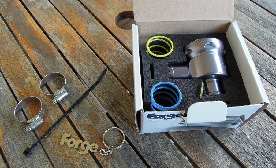

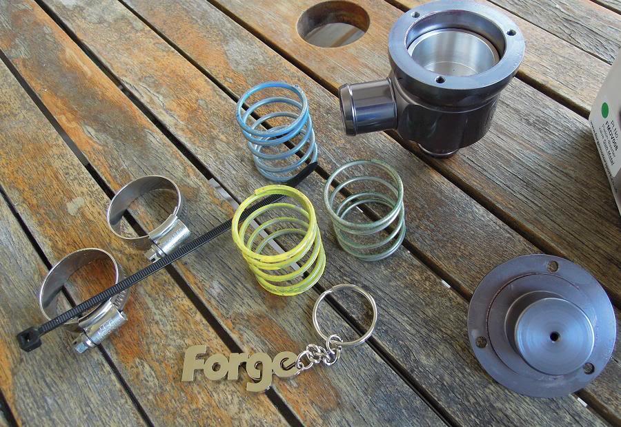

            Mine arrived today from TTStuff. Over 3 weeks, but thats what you get with surface mail.
            Its nicely packed, they've provided nice hose clamps, 3 springs, 3 shims, allen-key, even the cable tie for the vac line. Paint on the springs is a little crude, but obviously only to indicate which is which.
            There is a little glossy booklet that goes through how to install it in detail, but nothing on how to tune it, which spring is which and how to set it. I've noticed Forge is quite careful not to make any promises or figures with these products which is smart, there are so many variables. If you say it will hold 20 PSI, you might get people ringing, wondering why there otherwise stock car does not boost to 20PSI now.
            I'll have a play tomorrow, I could chuck the stock diverter back on to see / show any difference. Not really bothered, so let me know if that interests you.

                Diverter works well. I don't know if i'm holding any more boost, but the unit works well. With my setup you can hear backing off the throttle from 2000rpm, the pod filter setup makes it quite audible.
                The old (splitter) and the new (008 )
                Started with the Yellow spring and 1 washer, seemed fine. Tried 3 washers, sound became quite whistly which I assume is the air struggling to move past the valve. I've backed off to 2 springs, which seems to be a compromise of both
                From what I gather (reverse engineering), the role of the vacuum from the intake manifold plays a greater role than I had originally thought.
                If you try to press the valve open, like the boost does, it takes a lot of effort. If you suck on the vacuum nipple (ha!) you can feel it open reasonably easily.
                The sound of my Forge Splitter Valve and the 1 and 3 shim setups with the yellow spring in the 008 all sound a little different, this may sort of make some sense:
                Splitter: coooooh
                008 - 1 spring: cah
                008 - 3 spring: tssew
                make sense now?
