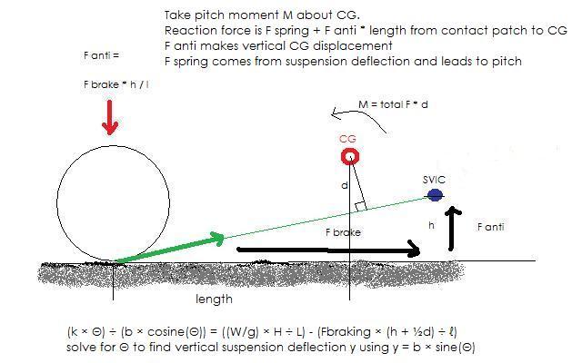

          The lowered rear control arm increases the inclination of the strut and hence the steering axis a bit which gives the increase in caster. The lowering also reduces the inbuilt antidive/lift (need to find some pics that show the anti-dive geometry so show why) which softens the front end under braking/acceleration which increases compliance so you can get away with a stiffer anti-roll bar without losing grip when turning in while braking.
            And here it shows why.
            The lower arm is inclined more to the rear which lowers the SVIC (Side View Instant Center) and moves it rearward so in the picture h is decrease and l is increased. This reduces the anti-dive force as shown.
