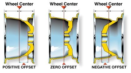

          "Question 1, doesn't a lower offset (from say ET43 to ET35) mean that the distance is reduced between the wheel and the centreline, which makes the inside of the wheel spokes closer to the calliper? Obviously the shape of the spokes make a difference, but the question is 'generally'."
          I think you should check out those offset diagrams, the design of the wheel is going to determined caliper clearance, offset is not particularly relevant to that.
          "Question 2, when the width of the tyre is increased (from 6.5" to 7"), is the width added to the outside of the tyre? I assume so otherwise it would rub on the inside wishbone/springs (whatever else)."
          Well, again this is a bit mislead, tyre width and wheel width are two different things for one, and secondly think of the offset of 0 as a constant, wheel width is added evenly to either side (in terms of offset...as offset is a measurement from the middle of the wheel regardless of its width). So... if the offset is the same on both the 6.5" wide and 7" wide wheels if I'm not mistaken the wheel extremities will be 0.25" closer to the suspension components and 0.25" on the other side towards the edge of the bodywork.
          Hope that clears up things a little, otherwise do a bit of reading through links on good, just a basic "what is wheel offset" will get a good basic response.
