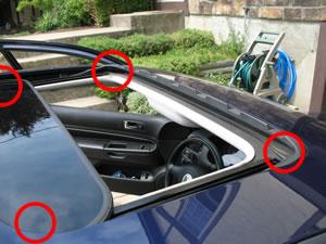

I finally found the problem. The passenger side sunroof drain pipe was blocked, then it causes the catchment to overflow causing the water to flow through the interior lining finally reaching the passenger foot well.. All I need now is something to unblock it lol
I believe its under the car, but what you do is open the sunroof, and then look from the top and you'll see two holes, one at each end, you'll then need to poke with a metal wire through it to clear it if its clogged.Originally posted by AUC-05L View Postwhere is the drain tube located? should to check mine...
If you find that its not clogged, then it means the pipe is not connected or is damaged.

I got mine unclogged using a high pressure compressor with the blower attachment.
I have the problem you describe at the moment, I would put my bets on the drain tubes.
Open your bonnet and check in the back corners, mine was chock full of leaves, blow it out.
I opened the sunroof and blew compressed air down the front two drain tubes to clear them until I could hear the air coming out of the corners I mentioned, this seems to have fixed the problem.
I would have water in the footwells without fail after rain, now there's nothing ...in the front.

Try the front drain tubes first, it will more than likely fix it for you, but check the rears as well

Small leaves and dirt make their way down the pipes and clog it, if you can use a whipper snipper wire, that would be the safest method to push it out, the other end of the tube is small and is below the windscreen for the front two drain holes, impossible to get to, i think its a grommet that is poorly designed..Originally posted by waxgti View Posthave you replaced your tubing, ive just found some pesky leaks over my seatbelts and a boot full of water - what did you use to replace the tubing?
