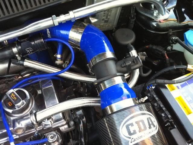

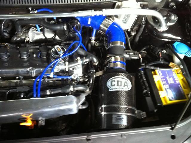

      I made a flat tray, out of 6mm aluminium plate

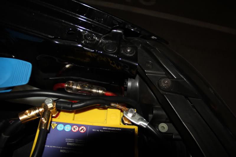

      You can buy the earth cable already done, which i did
      I had to extend the positive cable, just used a car audio joiner from Jaycar
      You will be amazed how much room is in there when you remove the airbox and battery

        Sorry dont have any really good pics
        You can actually see the join under the heat shrink on the positive wire

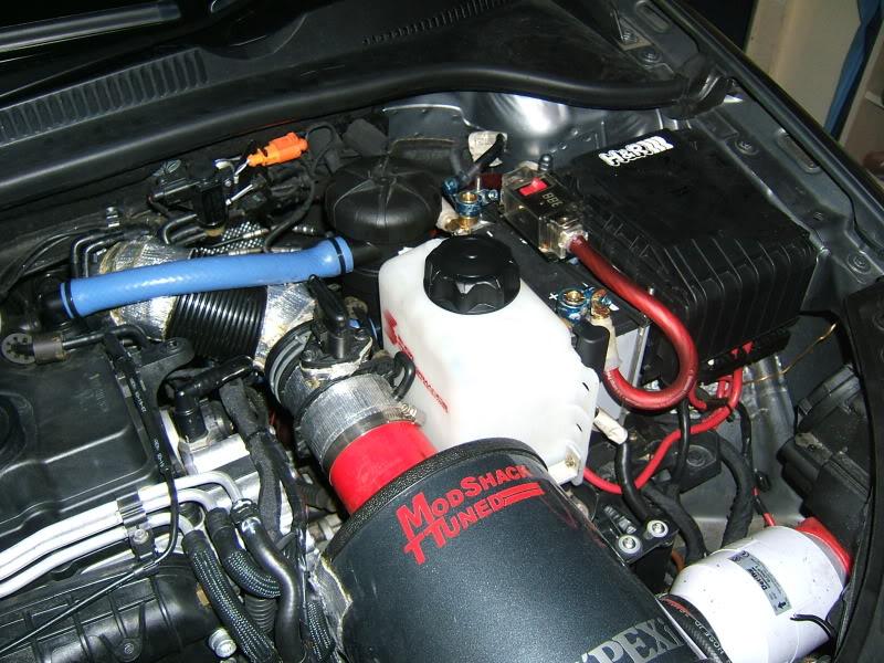

          I believe Polar is still running his tiny Deka motorcycle battery in his MKV GT TSI, but mine started to get weak after a year of turning over the high compression diesel and running my big sound system, I have a mid sized Oddessy and it's been awesome, plus a fraction of the stock size.
