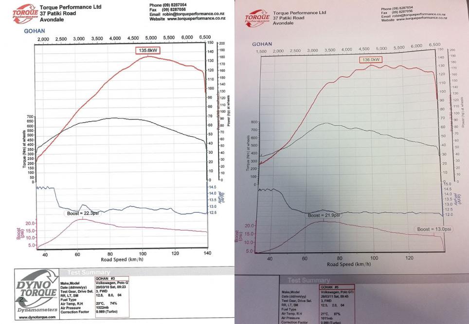

    Hi guys, had my car dynoed again after a year. The power was not as high as I hoped. Possibly due to 1) heat soak 2) crappy humid weather pouring down in rain 3) and reasonable temp and very small fan for the radiator and no air to the intercooler.
    Change from Dyno on left from 2010 and 2011
    1) REVO Stage 1 to Stage 2
    2) K&N Air filter
    3) Forge DV from green to yellow spring
    4) Forge TIP inlet
    5) New spark plugs (factory)
    I was told this could be most likely due to too advanced timing - as the car was tuned in winter when it was nice and cool.
    What do you guys think? I contacted my REVO dealer and he will drop the timing one step tomorrow. I think if I need more power - I need a FMIC.
    What are your thoughts? Peak power hasn't changed much - peak boost actually dropped a little which is interesting... ? yellow spring vs. green spring.
    Torque has increased a lot - and I did feel that... buttometer!
    06 Polo GTI - REVO Stage 2 = 140kw @ wheels.
    06 Golf GTI - Bluefin Stage 1 blacked out with ED30 theme, leather, xenon, etc.
    I will do VAGCOM tomorrow as well - as far as I know there is no error code.
    I am sure they have turned traction control off - can't be traction control can it?
    It was both done at 3rd gear. Peak torque on that dyno meter is almost 700 vs. 800. (this is only applicable from same car vs. same car at same gear - not in nm)

        As mentioned both runs on 3rd gear. 2010 one was sunny very dry 20 degree weather. 2011 run pouring down with rain (torrential almost!) humid 21 degree on paper.
        I don't know why the power / torque fluctuating at top. Fuel fine, boost seems okay too.

                I need to clarify that I do have 4bar FPR. My spark plugs were in nice colour when I took them out. So don't think a simple change in plugs issue here. I did agree on first post that FMIC is likely needed to go further. My main issue I believe was too advanced timing for NZ fuel and my current setup. I have now timing set at 6 instead of 7.
                Done some on road rolling measurements and seem to be doing well without any knocks or pulling.
                Boost 8, timing 6, fuel setting 8.
                See how we go. Might change the forge dv spring back to green but not think it's the issue here. Car goes well otherwise.

                  Its a Dyno... If its that long appart, could be a calibration or anything...
                  I perfer logging, at least the ECU is the same, so should give better comparison data.
                  There is more to boost than the Diverter, I'd be thinking about your SAI, N249 and N112 valves. I've gone back from the VAC mods, but it was def a different drive without them...

                    Personally id go a Go Fast Bits (GFB) or Baileys Diverter.
                    Found the fluctation of boost happened a lot with the Forge Diverters. By changing springs you wil notice will come in earlier/later as well.
                      It's the diverter valve... either it's leaking or the N249 was trying to use the diverter valve to control the boost a little given the temps.
                      I'd be bypassing the N249 (easy to do, and I got positive results with it) and repeating the process to see if it's still occuring. If it is still a problem after that, time for a new DV (or at least, a new seal/spring in your current DV)

                        My revo settings was boost 7 timing 5
                          Timing doesn't seem too bad.
                          The problem is heatsoak, as others have said get an FMIC.
                          The humidity shouldn't have much to do with it as the Dyno takes this into account and overcorrects for it.

                            I don't know what those settings mean, but logging the timing pull through VAG com will help you work it out and avoid pinging. I think the pull will over correct to avoid damage rather than pull just enough to prevent detonation.
                            Logging boost and N75 duty cycle will help show if the ECU is fluctuating boost at the top end.
                              Thanks guys.
                              Boost log on VCDS - was done on my dealer's laptop - apparently looked spot on. 25 psi requested, received 25psi delivered at peak. Requested and delivered boosts matched well throughout the rev range. Started off at 1200rpm and all the way to 6200rpm.
                              All readings were good on lowered timing.
                              DV spring will change the characteristic just like fuzion mentioned. As you see on graph - boost is not leaked out and there are no spikes. so personally i don't think it's the boost leak.
                              I will do more measurements as noone suggested. N75 duty cycle sounds like good idea. Noone - which blocks were they? can you recall? ta.
