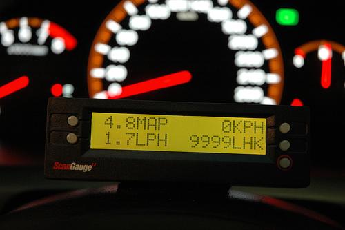

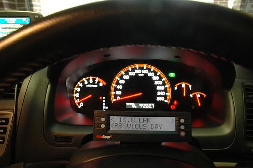

                        I just ordered my 2nd ScanGauge II, this one for the Polo. Whilst my Euro didn't have a fuel computer, the primary reason for my #2 is that of getting a digital km/h display that works in tunnels (!gps). The Polo's 80-100 km/h display range is completely f*d especially with current 15% error margin. Bonus will be the extra outputs e.g. boost from the ECU.
                        It looks like this in my Euro:
                        (notice how much better the normal speedo is)
                        Close up, you can output whatever you want, completely configurable.
                            OMG I want one! The crazy speed increments is about the only thing I hate about the Polo. I was hoping to find some sort of hidden trip computer function, and when I couldn't do that I tried to find something exactly like this. Obviously my Google skills are below par.
                            Their website says they only deliver to the US and Canada. Where have you ordered yours from?
