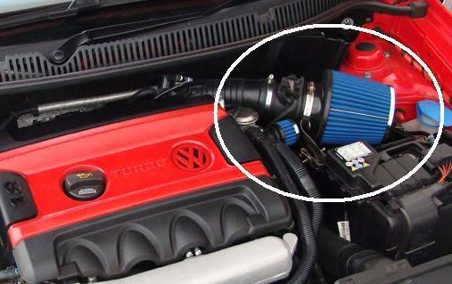

          Wouldn't there be issues with pulling in hot air? Might sound better but perform worse???

            Is this what we're talking about? (POD)
            Dave
            • #21
              Dave
              yep. thats the one
              • #22
                What is the extra filter for? BOV?
                • #23
                  I dont actually know. But it sucks in filtered air from the stock airbox. So i decided to put a filter on it. Everything seems to be working fine still.
                  • #24
                    It runs a second breather filter that sits under the main filter – that feeds the airpump for cold start emissions so it does not feed directly to the engine – none the less it needs to be filtered.
