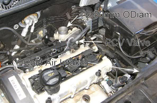

            Personally I'm just looking for an easy way to service the car, easy to get to the air filter and spark plugs. So I guess a pod filter would be the way to go, unless I find a better (easy access) enclosure for the same/different drop in panel which would be a cheaper ongoing cost I assume?? I measured the TB this alvo and it's 50mm at its outer diameter. It would also be great to use the cold air intake while I'm at it if anyone has any ideas.

                The cover over the exhaust is a heat collector used for cold starts. I was quiet surprised to see it there myself as I thought it was only used on carburated engines to help atomise the fuel mixture and prevent it from condensating along the inlet manifold. With injectors the fuel path is so short that I didn't think you'd need one of these at all, propably incorporated for the -50C syberian market Anyway it looks like there's a flap in the engine cover which grabs air from either the exhaust heat collector or from an opening near the cold air intake, not sure if it's a bi-metal or wax pallet mechanism.
                Best way to get cold air would be to grab it from outside and then into a closed enclosure airbox as it gets very hot under the bonnet... or even better would be to grab it inside the cabin... can't beat that crisp air con air in summer Our subaru grabs air from from under the front wheel arch via a hole in teh engine bay which is a good solution.
                  The thinner VTDA modshack or similar thin fully enclosed cannister filter, and use 50mm silicon fittings and 50mm alloy pipe off e-bay. Just make sure you seal it to the outside air, as even the smallest gap near the inlet vent allows hot air ingress, sealing the front of mine made a noticable response difference. Is the MAF in this section?

                    The MAF must be located under the throttle plate as its definatelly not in the engine cover assembly. From what I can see there's an electrical connector about 8cm under the throttle plate which is probably the MAF. I've never seen this sort of setup and am wondering how accurate the measurement is seeing the MAF is located in turbulent and not laminar flow?? Anyone know what kind of a sensor these engines use to measure the mass air flow?
