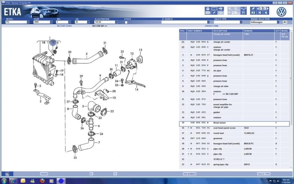

            Be aware, I don't think you can get boost from these controllers as the ECU does not have a boost pressure sensor. My understanding is that with our cars, Boost is calculated from some other data.

                            The 9n3 '05-on 1.8T GTI has a boost pressure sensor (called "thrust sensor" for some reason); this is one of the key elements in the Bosch ME7.5 ECU for turbocharged models. Took me abit of time to find it; but here it is:
                            I'm not sure how relevant it is to this discussion, but worth pointing out anyhow I think!

                              Does that mean that boost values taken from the ODB-II port are accurate? Hmm ...
