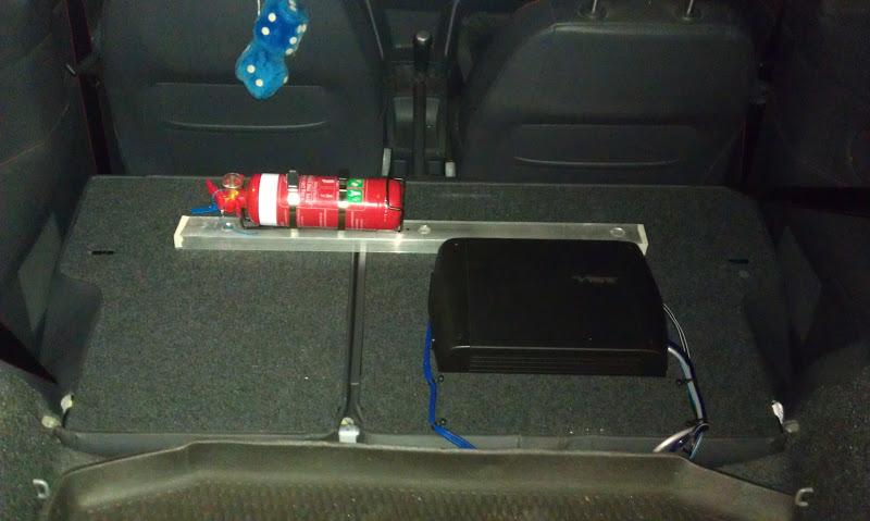

                  Well i gave up on waiting for an answer (impatient i know ) So I decided to try another avenue if anyone tracking their pog is interested...
                  The 9N Polo has three hook points bolted in at the back of the back seat (baby seat points? i dunno). So i removed the hooks and custom made an aluminium bracket (18 bucks from bunnings). I drilled holes in the aluminium to line up with the mounting points and bolted it in with the standard bolts. Prior to this, I drilled two more holes into the aliminium to securely mount the extinguisher bracket.
                  Lo and behold:
                  Ill go into spotlight or something and buy some felt the same color to make it look tidy. And the best part, no need to drill into any part of the car

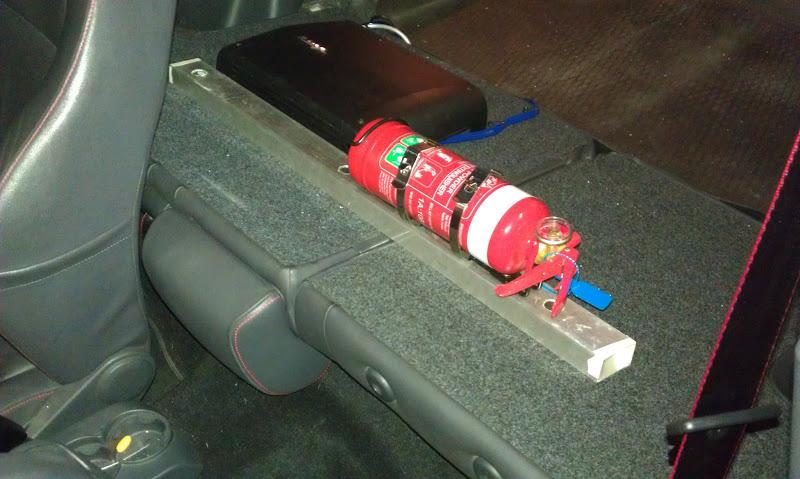

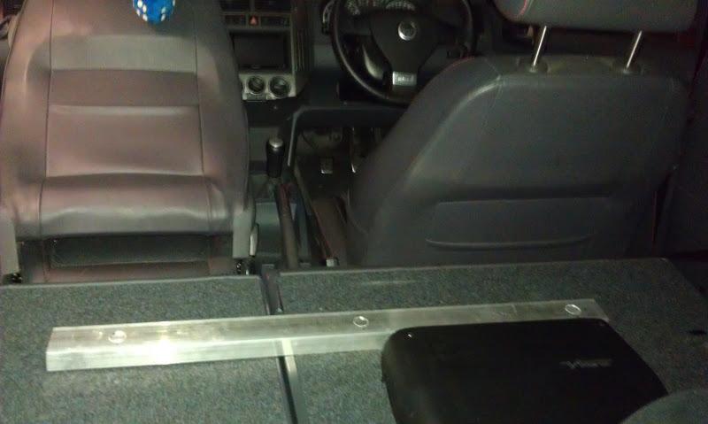

                    Sorry for the crappy pic but this is how I did it
                    1. Fixed 3mm aluminium flat rail bolted using seat bolts & bent to clear the underseat drawer
                    2. removable mount for extinguisher made of 90 degree aluminium
                        *pic*
                        I was looking at that location aswell but it looks like my drawer still gets in the way? Will definietely have to check yours out aswell though mate. I will give you a call on Friday and see where you are (hopefully the weather hold out, and i dont get called into work again)
                        Originally posted by seangti View Post
                        Hazrd - I'll assume that when tracking the car that you'll have the rear seats down so it's within reach? Otherwise it's going to be a PITA should you ever need it.
                        oh yeah for sure! the scruitineer guys wouldnt accept it otherwise its actually a really good spot, i dont even have to move my body to reach it, just my arm.
