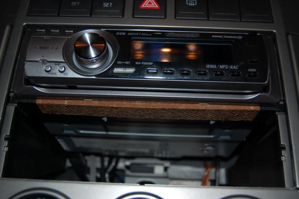

I installed a single din head unit without having to get an install kit. On either side of the hole from the removed headunit there is a slit on the inside half way up the side which i figured was where you insert a support for installing a single din head unit in the top. So i cut a piece of masonite to the correct width, wrapped the ends in some electrical tape to stop any movement and inserted into the slots. I took the rubber stopper off the rear of the stock head and put it on the rear of the new hu so now it's supported front and rear. One $20 single din tray from supercheap auto (as suggested here in another post) with a bit of filing for some of the plastic molding that is out of sight and it fits well.

Here you go!
The piece of masonite I cut to size to fit in the slots at either side. The black at each end is electrical tape wrapped around the masonite to stop it moving around in the slots.
With the tray installed underneath.

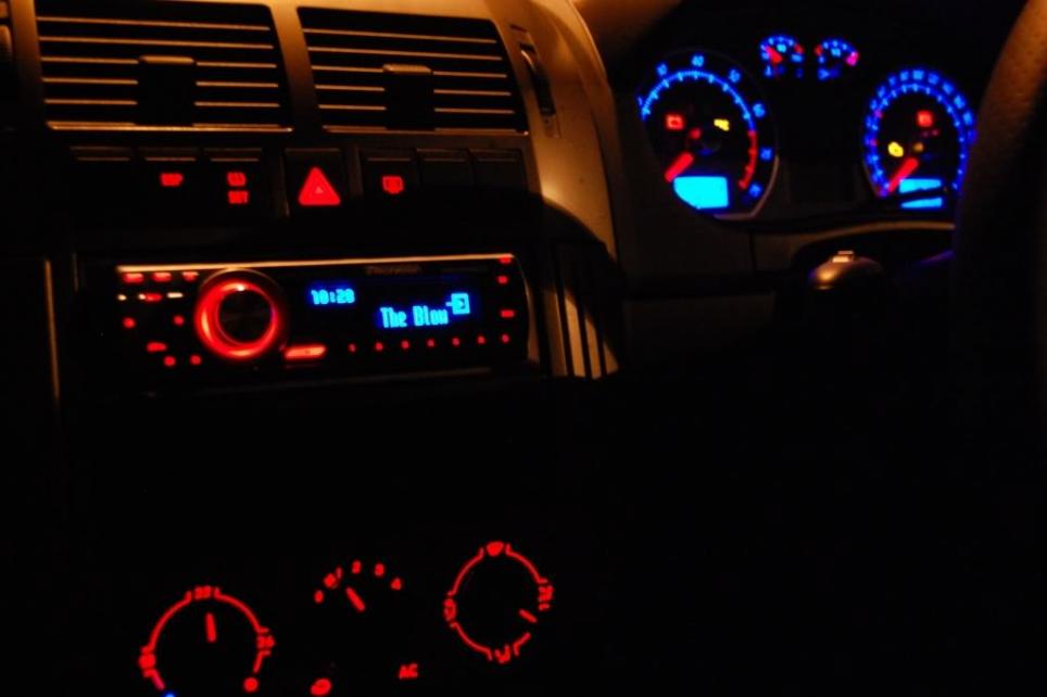

Colours on the headunit worked out almost perfectly. Total fluke considering I bought the headunit a year before the car. The blue on the dash is a lttle more purple but there isn't much in it.Last edited by morbo2000; 14-06-2007, 11:19 PM.

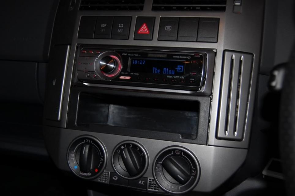

I ended up getting it installed by JB hifi Indooroopilly (QLD). And can i just say, fantastic job.
Took them hours, cause the fitting is so screwed... they ordered in a facia, which didn't fit, so they had to cut that, then fabricated a bracket of some sort... anyway... this is the final result... which i'm pretty happy about.
Worst camera phone in the world pictures... couldn't be bothered resizing them. So they are a little large.
