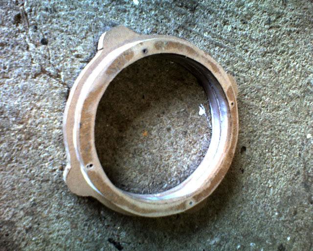

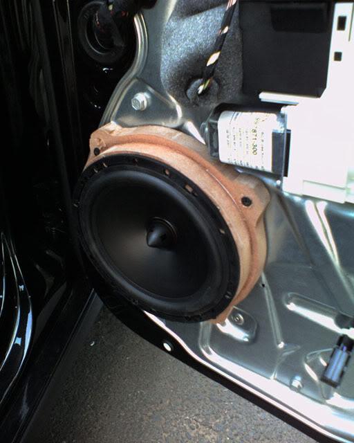

      i have replaced the front ones with 6,5" aftermarkets but ive had to make a spacer out of MDF otherwise you dont get enough depth for the magnets
      assembled spacer
      spacer on door with speaker mounted
      there are plastic spacers available but those probably would rattle and vibrate if you have strong speakers - so i suggest making your own out of MDF like i have done - and in that instance the minor differences in size dont really matter because the holes on the doors will be adequate for a 6,5" on the front and a 5,25" in the rear
