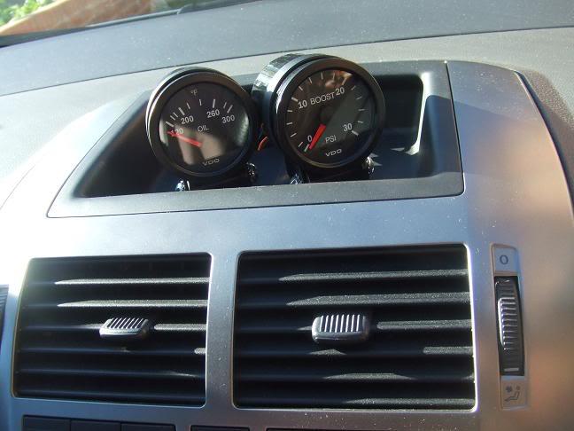

      I went for a Saber electronic item mounted on my steering column.
      I wrote up a guide on how to fit a gauge here: Click Me
