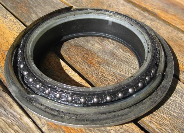

                            Here are a few pics of the good one, other one lost its bearings over the shop floor.
                            The seal looks to have had a good workout.

                              Originally posted by noone View Post
                              Very True about the Sydney roads taking their toll.
