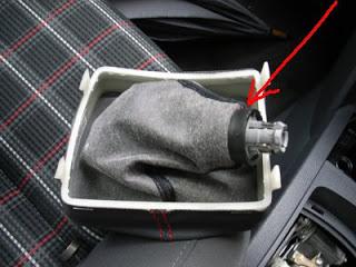

    Also, the gear knob is a bit loose anyone know how to tighten it up ?

        The gear knob is clamped to the gear stick, so it may be a bit hard to tighten. Not sure of a fix.

                If the the gear knob has a millimetre or two of play left to right, so does mine and i'm told thats normal and nothing can be done - grow to like it - fun to play with at lights - like worry beads.
                  The red arrow is showing "the thing"(i dunno what that called) which hold the gear knob you can adj. it with a screwdriver
