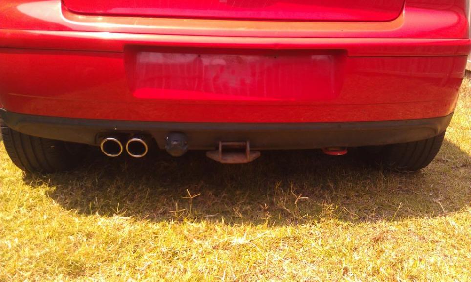

                        I had a VW towbar fitted to my car on the weekend, huge thanks to Gavin for the bar and for doing most of the work.
                        Did it require the rear bumper to be cut? Yes - you'll need to cut a small section out of the bottom of lower valance. It's about a 3x3 (inch) cut.
                        does the VW version come with a separate bumper? (I would assume not) Nope, no need, Just a small cut out required. The electrical fit kit (bit) looks pretty awful so perhaps at some point if I can find another valance I'll leave the electrical bit in the boot and pull out when needed.
                        has anyone had the Hayman Reese version installed? and how have you found that? Mine is a genuine VW one. I only have photo's without the bumpers on the car, not with it fitted. The specs on the bar are specific to the base diesel and petrol models, not GTI. Max towing will be around 500kg, with a ball weight of 55kg I think.
                        Pics of the car it came off. We cleaned up the bar and repainted it black so it looks better. Now to find an excuse to tow something.
                        Daily: 2010 VW Jetta Highline
                          Looks good - What brand tow bar did you use?
                            That's a VW branded bar. Still haven't towed anything, looking for excuses though
