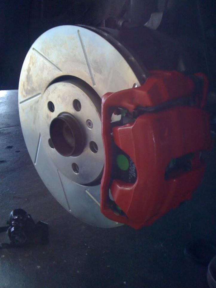

As a few people are looking at upgrading their standard front brake rotors and pads to better items, I thought I would show people how I did mine when I was home recently.
First I started with buying some new front rotors off ECS and some new EBC Greenstuff pads from a the RDA/EBC dealer in Penrith.
Next, I raised the front of the car, placed it on stands, removed the front wheels, and found the appropriate sockets and spanners.
Then, undoing the bolts that hold the caliper to the hub carrier, remove the caliper and zip tie out of the way...Be sure not to kink the brake line when doing this...
Remove the retaing screw for the rotor, then remove the rotor. Mine was stuck in place pretty good, but I used some WD-40, a block of wood and a hammer to loosen the rotor and remove it.
Place new rotor on the hub, and screw in retaining screw...
At this stage I replaced my brake pads to the EBC Greenstuff pads.
After replacing the pads, I then remounted the caliper, then applied Loctite threadlocker to the bolts. I also gave the calipers a good clean while I could too.
After pumping the brakes to seat the pads, I remounted the wheels and went and bedded the brakes in.
