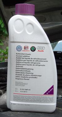

    Anyway - I must 'fess up to the fact that I do have a question that I hope someone will be able to answer for me...what's in the Coolant bottle (don't say "coolant" please! :p) ?
    I was having a bit of a poke around under the bonnet (having a bit of a sticky beak, as well as checking to see if the fluid dripping from the car was oil (it wasn't, and is presumably water from the air conditioning) and I noticed that the coolant was...pink!
    Pretty much every car I've ever taken a look under the bonnet of (including a MK 3 VR6 that's in the family) has had green coolant inside their coolant bottles, and I'm wondering if the GTI's running some sort of special coolant?
    I guess I'm asking because I spend a bit of time in peak hour traffic, which is pretty much the worst conditions for the cooling system, and I keep an eye on my coolant reservoir which isn't sitting on max, but close enough for me not to worry about it (yet).
    Does anywhere know where I can get some of this pink coolant from?

    Pink coolant, just top it up with water unless you have a serious problem and then it will be under warranty!

        Just a note on the coolant - I decided to see if it was in the manual...apparently, you need to dilute G12 plus coolant concentrate to 40-60% and put that in the coolant reservoir.
        I guess a trip down to a parts division might be the goer

          Seriosuly, my understanding is you can use water for minimal top ups, but anything significant (which implies a significant problem) you will need the mix

                  Welcome! Is the wand that you weave used for water divining? If so, I hope it finds distilled water! Don't top up with tap water as it contains salts that will cause corrosion or blockages and adversely affect the performance of your G12.
                  Anyway, you shouldnt need to add coolant for a very long time (on a properly maintained engine this means forever!)
