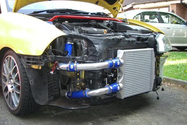

        @Rosonic: It's a verry new kit and i diddn't find it neither on the Forge website. it's not on it yet.
        but i saw pictures of the kit on a Ibiza and i saw a Forge logo on it.
        so i went to a local Forge dealer nearby and let them contacted Forge for asking about the kit.
        apparently it's a new kit wich can be ordered under the refnr: "FM SKINT"
        @h100vw: Thanks for replacing the topic
        @pologti1.8T: don't know how much it weighs exacly, i think around 4 - 5 KG's
        @seangti: a few weeks ago we have had 38C°, and last winter we have had -24C°, so w get verry extreme wheater sometimes
        i don't expect to much trouble with the radiator, i also do not drive hard constant in hot wheater because it's not that ideal for the engine.
        but i'm planning to get another heat sensor that the radiator fans will react quicker and start to work on lower water temp.
        just to be sure.
        as for the rest, i know that the seat intercooler can flow perfect to 350Hp.
        i have know serveral people with this intercooler on Ibiza's 20VT's and it's allready proven that that intercooler works great on 1.8T petrol engines.
        so i don't expect any problems with it.
        if it does, i will keep you guys informed

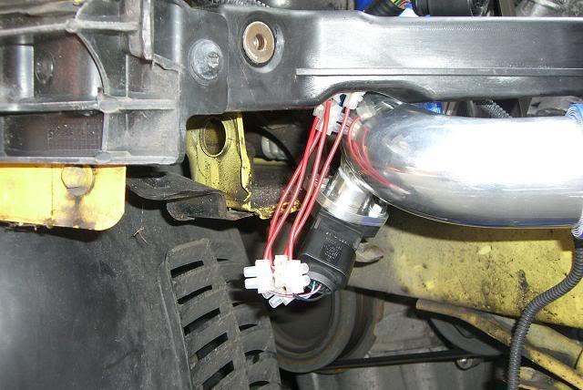

                  btw, here are the rest of the pictures...

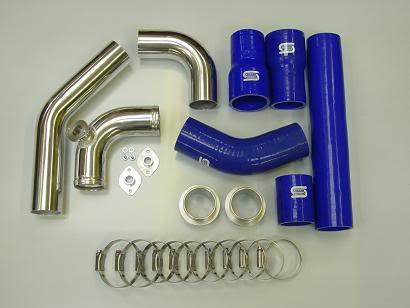

                    Had a reply from Forge over night (must say I am supprised):
                    "Thanks for the email
                    We do not have much information on this kit as it was conceived by the SEAT forum members who just bought our race part accessories . I have attached all the info I can find .
                    I have no fitting instruction nor any other advice , the cost is to you ( discounted as your are in Australia ) would be £ 200 GBP + potage
                    let me know if I can help further "
                    Here are a few photos of the kit:
                    By the time we arranged for a group buy discount and freight, unless we could avoid VAT, don't think its going to be worth it...
