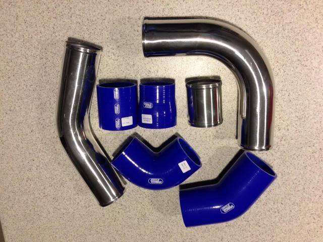

First off enlarging the diameter IC pipe sizing to 2.5" on the cold side now there's enough air flow to warrant it. Just waiting on the MAP flange to get here.

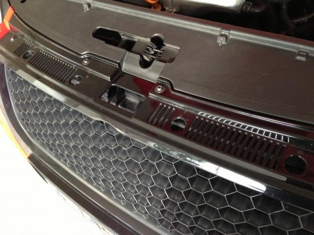

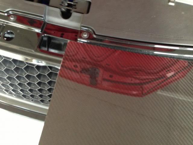

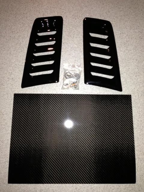

So Phase I of project aero arrived yesterday plus the MAP flange I've been waiting for forever.

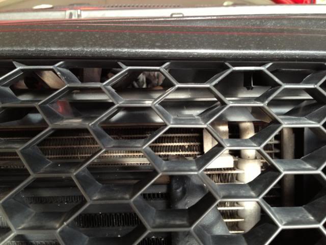

The carbon sheet is to cover these well thought out grilles that let out pressurized air pre-FMIC and Rad that escapes north and just hits the rubber bonnet seal.
The sheet is only 1mm thick and rigid but still has some flex to it.
And also thinking of covering the old factory airbox intake entry also which VW put on both sides of the car.

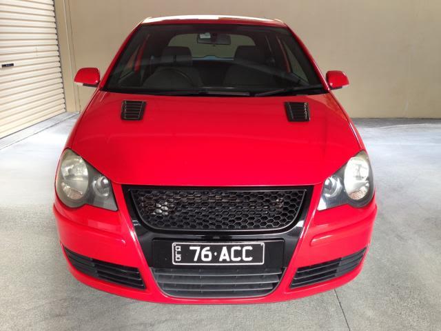

And to help air flow and heat escape from the engine bay are the Ford Focus RS bonnet vents
A bit 'because race car" but meh, functional and look ok I think.
I have 1/2 of the rubber strip at the rear of the engine bay removed to help the hot air escape, not had any issues with water getting in and helps the snail heat go somewhere.
That is awesome!! Colour coding the vents or leaving them black?
